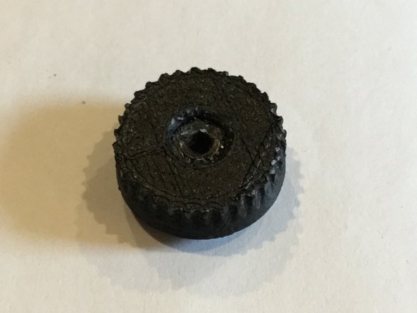

  1. Yaesu VX8DR PLASTIC ROTARY KNOB Replacement, Ye olde knob: crwdns2935265:01crwdnd2935265:01crwdnd2935265:02crwdne2935265:0 Yaesu VX8DR PLASTIC ROTARY KNOB Replacement, Ye olde knob: crwdns2935265:01crwdnd2935265:02crwdnd2935265:02crwdne2935265:0
    • The original rotary knob is quite worn. This is a rubber piece that is bonded to hard plastic underneath. This rubber can seperate in time so we're going to replace it with a 3d printed knob
    • Note: I don't see how this repair/modification would affect the waterproof status of the radio. I guess if you wanted you could put a tiny dab of silicone on the screw before you put it back in but it doesn't look like Yaesu did anything like that from the factory. Just know that you are attempting this repair/modification at your own risk

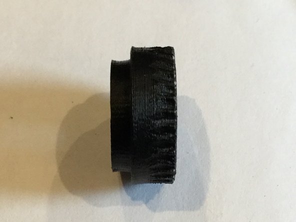

  3. Yaesu VX8DR PLASTIC ROTARY KNOB Replacement, Out with the old. In with the new.: crwdns2935265:03crwdnd2935265:01crwdnd2935265:03crwdne2935265:0 Yaesu VX8DR PLASTIC ROTARY KNOB Replacement, Out with the old. In with the new.: crwdns2935265:03crwdnd2935265:02crwdnd2935265:03crwdne2935265:0 Yaesu VX8DR PLASTIC ROTARY KNOB Replacement, Out with the old. In with the new.: crwdns2935265:03crwdnd2935265:03crwdnd2935265:03crwdne2935265:0
    • After removing the screw you can gently pry or pull the old knob off. Now would be a good time to clean out the crevices on the radio where the old knob sat.
    • You will now want to get your newly printed knob. Use the .stl file at the bottom of the page to either print your own or have it printed and shipped to you.
    • I printed this one in ABS but it would probably be even better in PLA. I printed this one with the top on the print bed. (upside down)

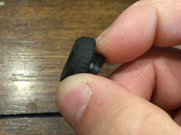

  4. Yaesu VX8DR PLASTIC ROTARY KNOB Replacement, Test fit and adjust: crwdns2935265:04crwdnd2935265:01crwdnd2935265:01crwdne2935265:0
    • You will now want to put the new knob on the rotary encoder. You can see that there are 2 rounded sides and 2 flat sides and they have to go together in that orientation.
    • Test fit it first and make sure it will fit snugly. You will have to use some pressure to get it on but don't get excessive. You may have to use a razor blade or exacto knife to shave a bit of plastic off of the rounded or flat sides of the inner wall to get a smooth, but snug, fit on the rotary encoder.
