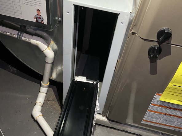

    • Pull the handhold with force in order to open the 'door' to the filter's location.
    • You will hear a 'pop' and the door should come off easily.

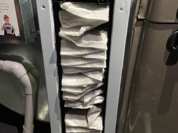

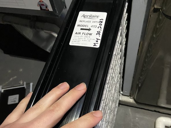

    • Remove the old filter completely by pulling the filter out of its location.
    • On the top of the filter there is an arrow pointing in a specific direction. Make sure you remember that direction.
  4. YORK TM9Y080B12MP11 Furnace Filter Replacement: crwdns2935265:04crwdnd2935265:01crwdnd2935265:02crwdne2935265:0 YORK TM9Y080B12MP11 Furnace Filter Replacement: crwdns2935265:04crwdnd2935265:02crwdnd2935265:02crwdne2935265:0
    • Insert the new filter by sliding it into the same place where the old filter was.
    • Make sure that the arrow on the top of the filter is pointing in the same direction as the old filter was.
    • Make sure that the filter is as far back as it can go.

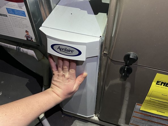

    • Reattach the door by lining it up with the inside edges of the opening.
    • Use force to make sure that the door is fully secure into its position so that the door does not fall off. You should hear a sound similar to a click once the door is correctly in place.
