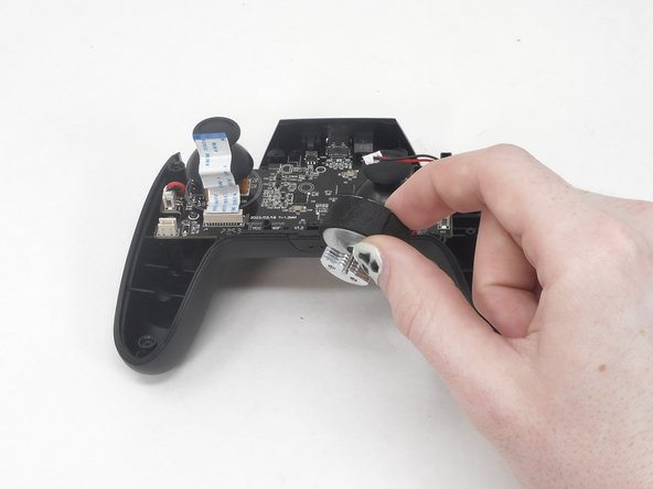

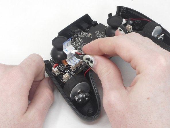

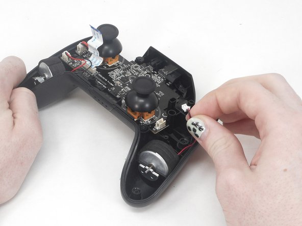

  8. YCCTEAM YCC-SW4001 Vibration Motor Replacement, Vibration Motor: crwdns2935265:08crwdnd2935265:01crwdnd2935265:03crwdne2935265:0 YCCTEAM YCC-SW4001 Vibration Motor Replacement, Vibration Motor: crwdns2935265:08crwdnd2935265:02crwdnd2935265:03crwdne2935265:0 YCCTEAM YCC-SW4001 Vibration Motor Replacement, Vibration Motor: crwdns2935265:08crwdnd2935265:03crwdnd2935265:03crwdne2935265:0
    • On the front side, disconnect the two vibration motor motherboard connectors.
    • Do not pull on the wires.
    • When replacing the rumble motors, press each plug down into its socket until it snaps into place.

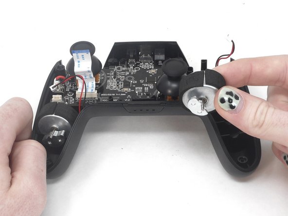

  9. YCCTEAM YCC-SW4001 Vibration Motor Replacement: crwdns2935265:09crwdnd2935265:01crwdnd2935265:03crwdne2935265:0 YCCTEAM YCC-SW4001 Vibration Motor Replacement: crwdns2935265:09crwdnd2935265:02crwdnd2935265:03crwdne2935265:0 YCCTEAM YCC-SW4001 Vibration Motor Replacement: crwdns2935265:09crwdnd2935265:03crwdnd2935265:03crwdne2935265:0
    • Remove the rumble motors from the controller grips.
