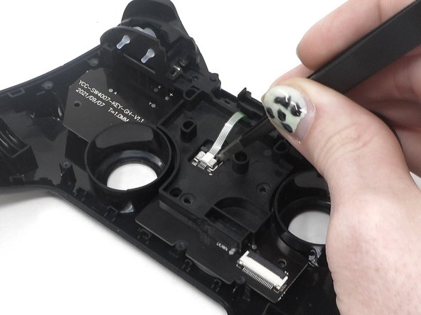

    • Slightly lift the front case.
    • Do not remove the front cover completely; it is still attached to the motherboard by a white ribbon cable.
  6. YCCTEAM YCC-SW4001 Shoulder Buttons Replacement: crwdns2935265:06crwdnd2935265:01crwdnd2935265:03crwdne2935265:0 YCCTEAM YCC-SW4001 Shoulder Buttons Replacement: crwdns2935265:06crwdnd2935265:02crwdnd2935265:03crwdne2935265:0 YCCTEAM YCC-SW4001 Shoulder Buttons Replacement: crwdns2935265:06crwdnd2935265:03crwdnd2935265:03crwdne2935265:0

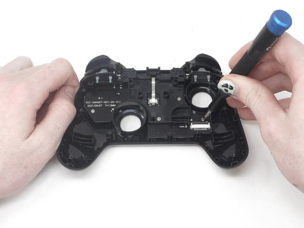

    • Use the tip of the opening pick to flip up the black locking flap of the ZIF connector.
    • The black flap holds the white ribbon cable in place.
  7. YCCTEAM YCC-SW4001 Shoulder Buttons Replacement: crwdns2935265:07crwdnd2935265:01crwdnd2935265:02crwdne2935265:0 YCCTEAM YCC-SW4001 Shoulder Buttons Replacement: crwdns2935265:07crwdnd2935265:02crwdnd2935265:02crwdne2935265:0
    • Use tweezers to disconnect the white ribbon cable from the ZIF connector.
  8. YCCTEAM YCC-SW4001 Shoulder Buttons Replacement: crwdns2935265:08crwdnd2935265:01crwdnd2935265:01crwdne2935265:0
    • Remove the front case.

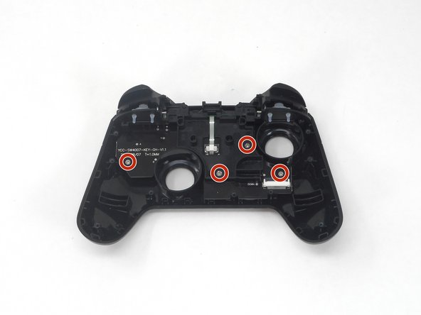

    • Flip over the front cover and remove the four 5.8 mm screws from the rear of the front cover using a Phillips screwdriver.
  10. YCCTEAM YCC-SW4001 Shoulder Buttons Replacement: crwdns2935265:010crwdnd2935265:01crwdnd2935265:03crwdne2935265:0 YCCTEAM YCC-SW4001 Shoulder Buttons Replacement: crwdns2935265:010crwdnd2935265:02crwdnd2935265:03crwdne2935265:0 YCCTEAM YCC-SW4001 Shoulder Buttons Replacement: crwdns2935265:010crwdnd2935265:03crwdnd2935265:03crwdne2935265:0

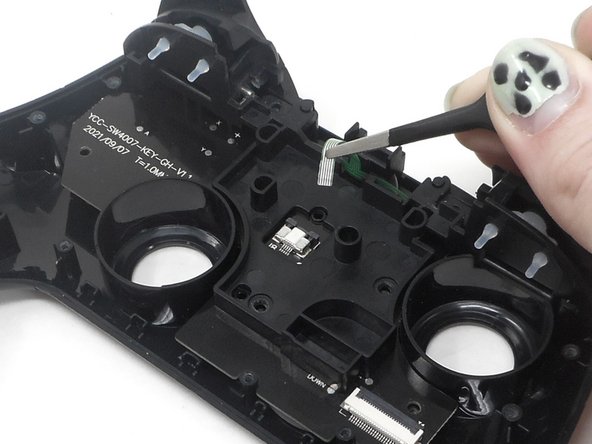

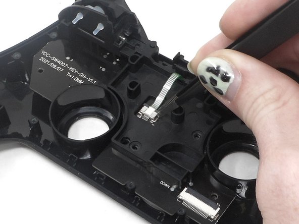

    • Flip up the ZIF locking flap.
  11. YCCTEAM YCC-SW4001 Shoulder Buttons Replacement: crwdns2935265:011crwdnd2935265:01crwdnd2935265:02crwdne2935265:0 YCCTEAM YCC-SW4001 Shoulder Buttons Replacement: crwdns2935265:011crwdnd2935265:02crwdnd2935265:02crwdne2935265:0
    • Disconnect the cable from the ZIF connector using tweezers or by hand.

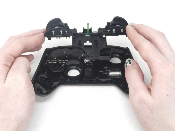

  12. YCCTEAM YCC-SW4001 Shoulder Buttons Replacement: crwdns2935265:012crwdnd2935265:01crwdnd2935265:02crwdne2935265:0 YCCTEAM YCC-SW4001 Shoulder Buttons Replacement: crwdns2935265:012crwdnd2935265:02crwdnd2935265:02crwdne2935265:0
    • Remove the circuit board and shoulder buttons assembly from the front cover.

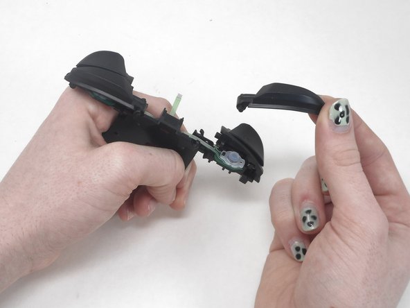

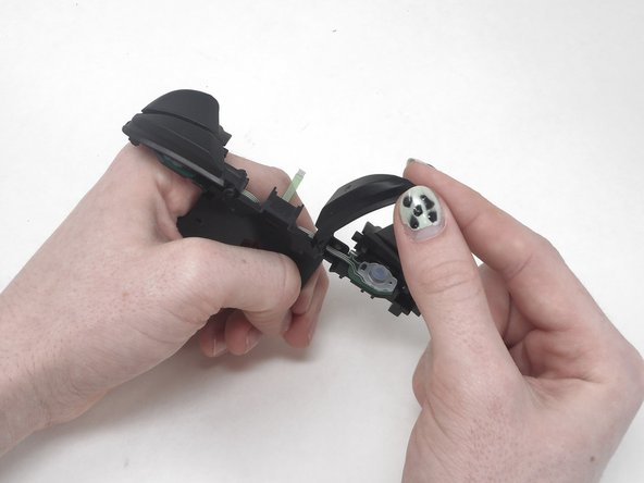

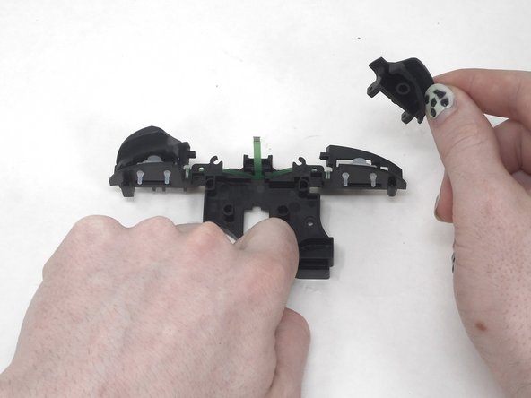

    • Remove the R button by hand.

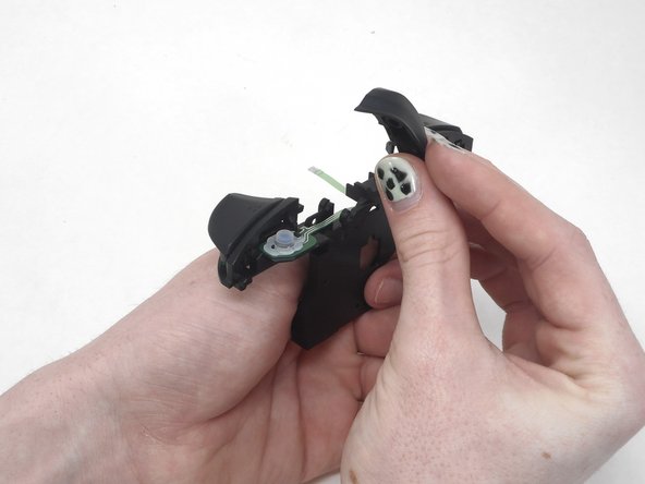

  14. YCCTEAM YCC-SW4001 Shoulder Buttons Replacement: crwdns2935265:014crwdnd2935265:01crwdnd2935265:03crwdne2935265:0 YCCTEAM YCC-SW4001 Shoulder Buttons Replacement: crwdns2935265:014crwdnd2935265:02crwdnd2935265:03crwdne2935265:0 YCCTEAM YCC-SW4001 Shoulder Buttons Replacement: crwdns2935265:014crwdnd2935265:03crwdnd2935265:03crwdne2935265:0
    • Remove the L button by hand.

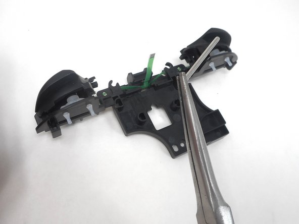

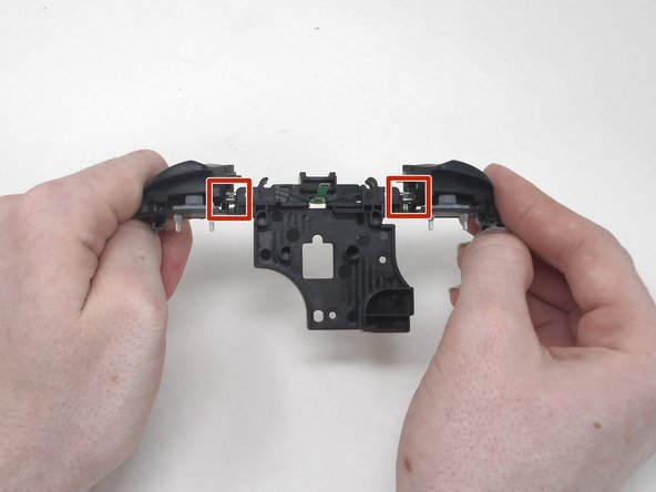

    • Flip the shoulder buttons attachment and look at the metal rods.

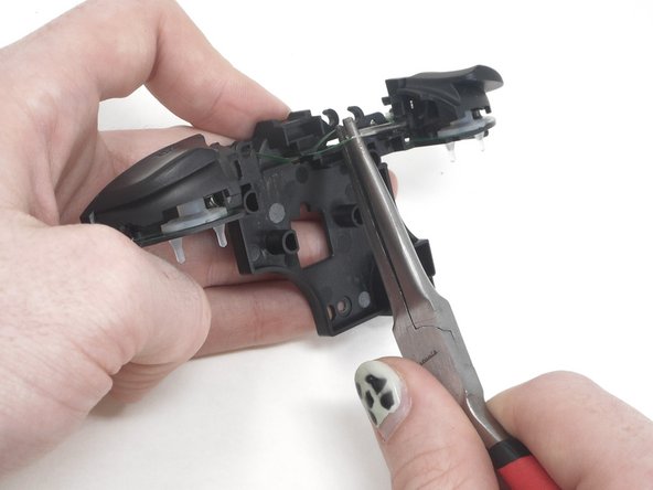

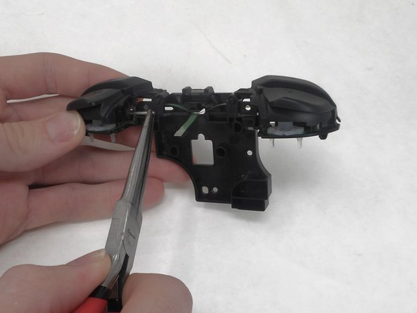

  15. YCCTEAM YCC-SW4001 Shoulder Buttons Replacement: crwdns2935265:015crwdnd2935265:01crwdnd2935265:03crwdne2935265:0 YCCTEAM YCC-SW4001 Shoulder Buttons Replacement: crwdns2935265:015crwdnd2935265:02crwdnd2935265:03crwdne2935265:0 YCCTEAM YCC-SW4001 Shoulder Buttons Replacement: crwdns2935265:015crwdnd2935265:03crwdnd2935265:03crwdne2935265:0

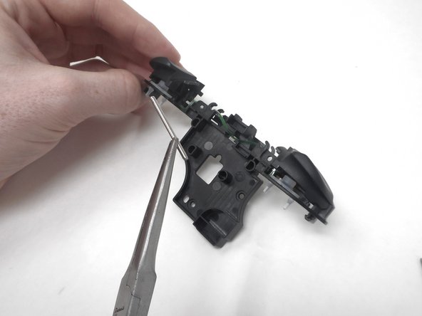

    • Remove the metal rod under "ZL" using the small needle nose pliers.
  16. YCCTEAM YCC-SW4001 Shoulder Buttons Replacement: crwdns2935265:016crwdnd2935265:01crwdnd2935265:03crwdne2935265:0 YCCTEAM YCC-SW4001 Shoulder Buttons Replacement: crwdns2935265:016crwdnd2935265:02crwdnd2935265:03crwdne2935265:0 YCCTEAM YCC-SW4001 Shoulder Buttons Replacement: crwdns2935265:016crwdnd2935265:03crwdnd2935265:03crwdne2935265:0
    • Remove the metal rod under "ZR" using small needle nose pliers.

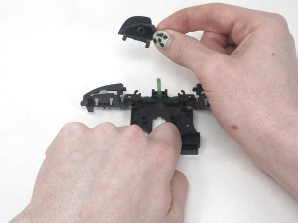

  17. YCCTEAM YCC-SW4001 Shoulder Buttons Replacement: crwdns2935265:017crwdnd2935265:01crwdnd2935265:03crwdne2935265:0 YCCTEAM YCC-SW4001 Shoulder Buttons Replacement: crwdns2935265:017crwdnd2935265:02crwdnd2935265:03crwdne2935265:0 YCCTEAM YCC-SW4001 Shoulder Buttons Replacement: crwdns2935265:017crwdnd2935265:03crwdnd2935265:03crwdne2935265:0
    • Remove the ZL and ZR buttons by hand.
