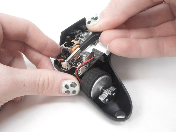

    • Use the tip of the opening pick to flip up the black locking flap of the ZIF connector.
    • The black flap holds the white ribbon cable in place.

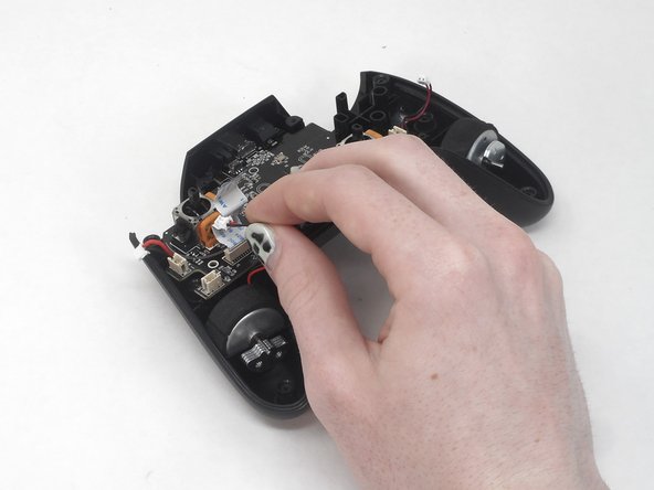

    • Use tweezers to disconnect the white ribbon cable from the ZIF connector.

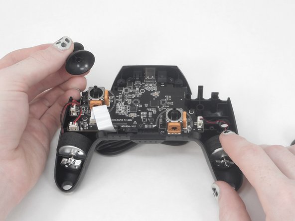

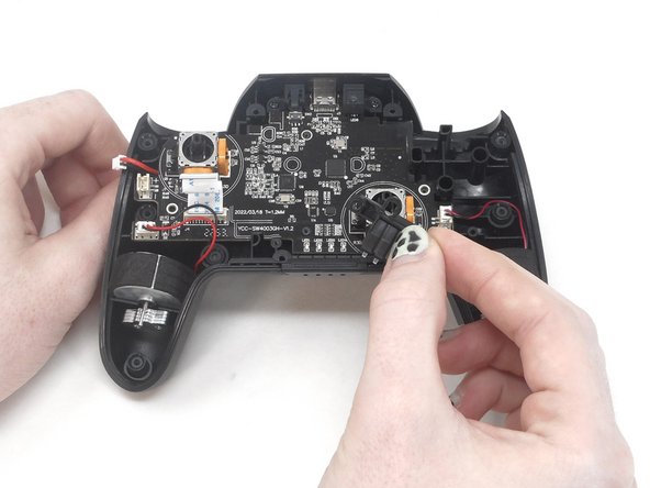

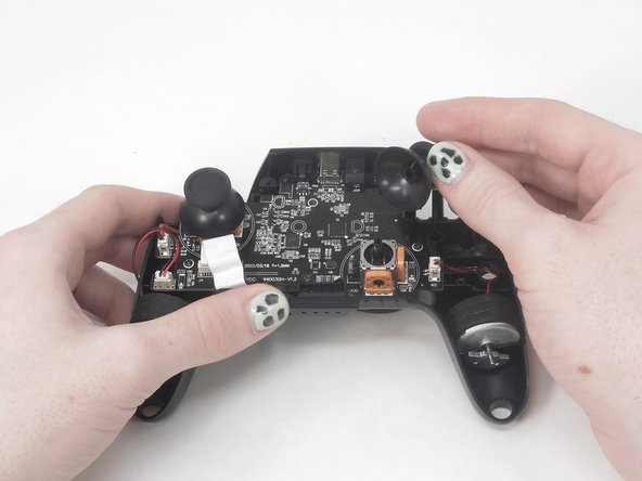

    • Remove the two joystick covers from the motherboard by gripping them and pulling them straight upward with moderate force.
  9. YCCTEAM YCC-SW4001 Joystick Replacement: crwdns2935265:09crwdnd2935265:01crwdnd2935265:03crwdne2935265:0 YCCTEAM YCC-SW4001 Joystick Replacement: crwdns2935265:09crwdnd2935265:02crwdnd2935265:03crwdne2935265:0 YCCTEAM YCC-SW4001 Joystick Replacement: crwdns2935265:09crwdnd2935265:03crwdnd2935265:03crwdne2935265:0

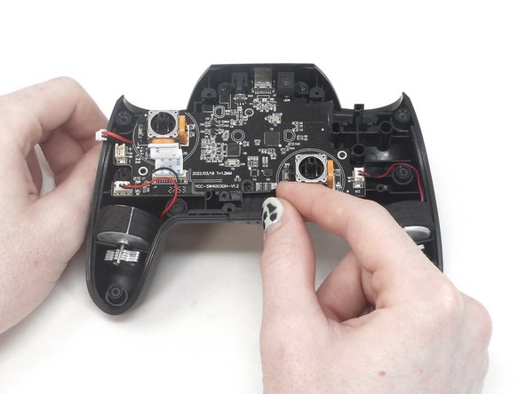

    • Use tweezers to lift the battery connector directly up and out of its motherboard port.

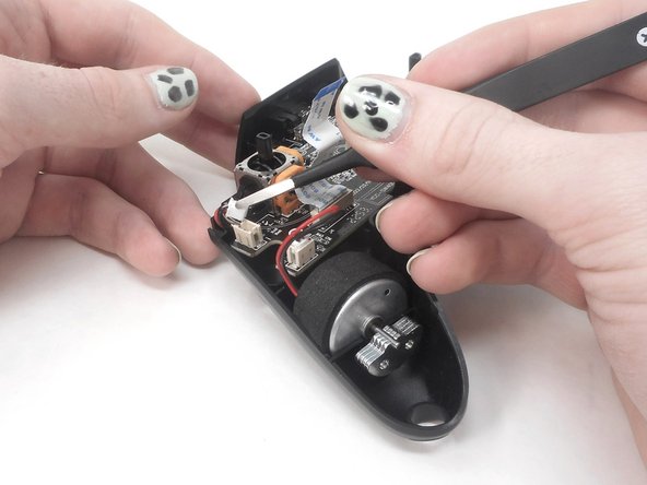

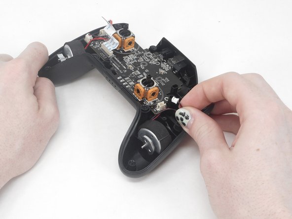

    • Grip the white rumble motor motherboard connections and pull them directly out of their ports.
    • When replacing the rumble motors, press each plug down into its socket until it snaps into place.
  12. YCCTEAM YCC-SW4001 Joystick Replacement: crwdns2935265:012crwdnd2935265:01crwdnd2935265:02crwdne2935265:0 YCCTEAM YCC-SW4001 Joystick Replacement: crwdns2935265:012crwdnd2935265:02crwdnd2935265:02crwdne2935265:0

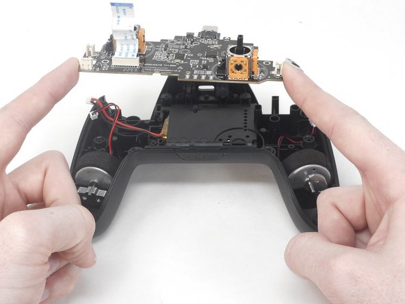

    • Lift the motherboard out of the controller.
