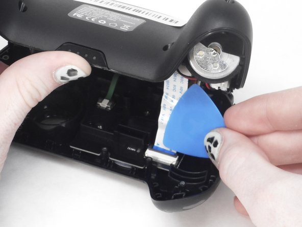

  2. YCCTEAM YCC-SW4001 Battery Replacement: crwdns2935265:02crwdnd2935265:01crwdnd2935265:03crwdne2935265:0 YCCTEAM YCC-SW4001 Battery Replacement: crwdns2935265:02crwdnd2935265:02crwdnd2935265:03crwdne2935265:0 YCCTEAM YCC-SW4001 Battery Replacement: crwdns2935265:02crwdnd2935265:03crwdnd2935265:03crwdne2935265:0
    • Use an opening pick to pry the back cover off of the controller.

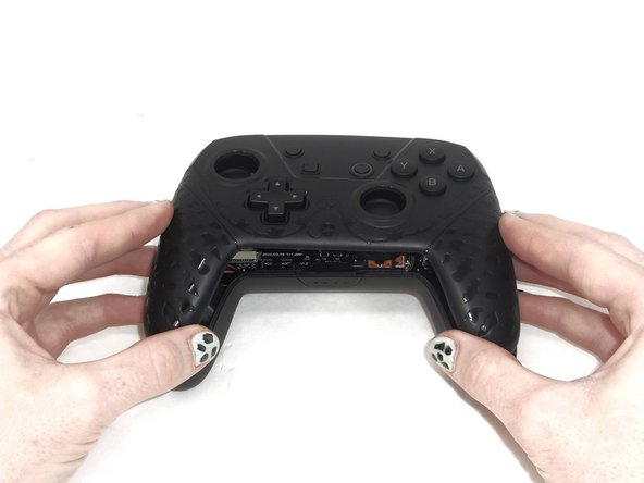

  4. YCCTEAM YCC-SW4001 Battery Replacement, Remove two additional screws: crwdns2935265:04crwdnd2935265:01crwdnd2935265:01crwdne2935265:0
    • On some models there are two more Phillips head screws on the sides that need to be removed before the front and back panels can be separated.

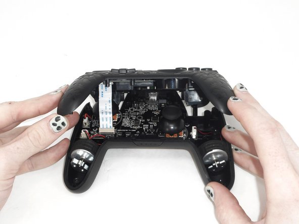

  5. YCCTEAM YCC-SW4001 Battery Replacement: crwdns2935265:05crwdnd2935265:01crwdnd2935265:03crwdne2935265:0 YCCTEAM YCC-SW4001 Battery Replacement: crwdns2935265:05crwdnd2935265:02crwdnd2935265:03crwdne2935265:0 YCCTEAM YCC-SW4001 Battery Replacement: crwdns2935265:05crwdnd2935265:03crwdnd2935265:03crwdne2935265:0
    • Slightly lift the front case.
    • Do not remove the front cover completely; it is still attached to the motherboard by a white ribbon cable.

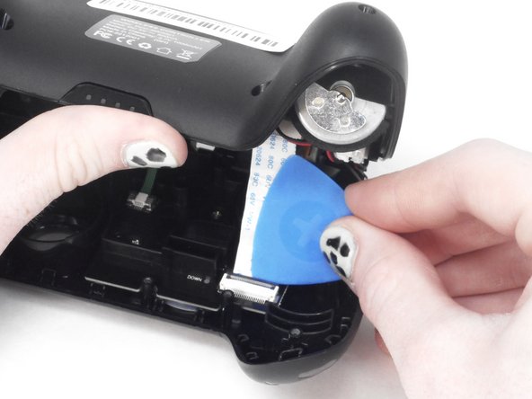

  6. YCCTEAM YCC-SW4001 Battery Replacement: crwdns2935265:06crwdnd2935265:01crwdnd2935265:03crwdne2935265:0 YCCTEAM YCC-SW4001 Battery Replacement: crwdns2935265:06crwdnd2935265:02crwdnd2935265:03crwdne2935265:0 YCCTEAM YCC-SW4001 Battery Replacement: crwdns2935265:06crwdnd2935265:03crwdnd2935265:03crwdne2935265:0

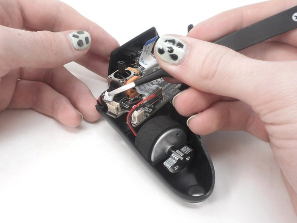

    • Use the tip of the opening pick to flip up the black locking flap of the ZIF connector.
    • The black flap holds the white ribbon cable in place.

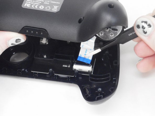

  7. YCCTEAM YCC-SW4001 Battery Replacement: crwdns2935265:07crwdnd2935265:01crwdnd2935265:02crwdne2935265:0 YCCTEAM YCC-SW4001 Battery Replacement: crwdns2935265:07crwdnd2935265:02crwdnd2935265:02crwdne2935265:0
    • Use tweezers to disconnect the white ribbon cable from the ZIF connector.

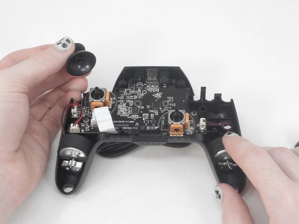

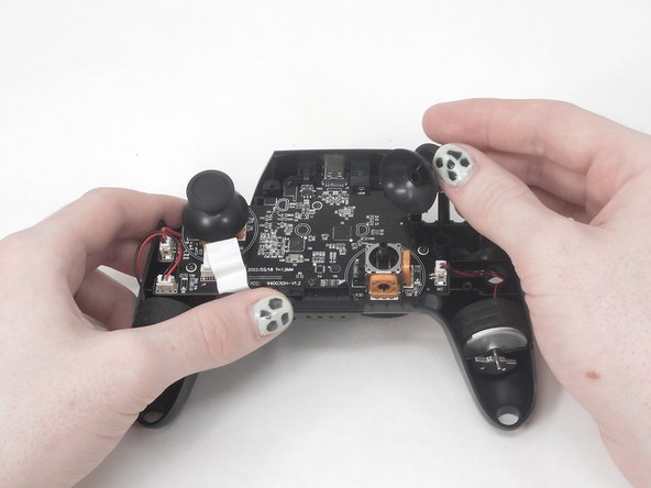

  9. YCCTEAM YCC-SW4001 Battery Replacement, Battery: crwdns2935265:09crwdnd2935265:01crwdnd2935265:03crwdne2935265:0 YCCTEAM YCC-SW4001 Battery Replacement, Battery: crwdns2935265:09crwdnd2935265:02crwdnd2935265:03crwdne2935265:0 YCCTEAM YCC-SW4001 Battery Replacement, Battery: crwdns2935265:09crwdnd2935265:03crwdnd2935265:03crwdne2935265:0

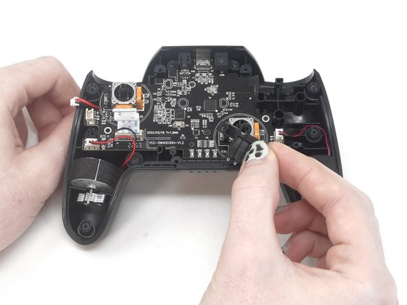

    • Remove the two joystick covers by gripping them and pulling them straight upward with moderate force.
  10. YCCTEAM YCC-SW4001 Battery Replacement: crwdns2935265:010crwdnd2935265:01crwdnd2935265:03crwdne2935265:0 YCCTEAM YCC-SW4001 Battery Replacement: crwdns2935265:010crwdnd2935265:02crwdnd2935265:03crwdne2935265:0 YCCTEAM YCC-SW4001 Battery Replacement: crwdns2935265:010crwdnd2935265:03crwdnd2935265:03crwdne2935265:0
    • Use tweezers to grip the white plastic battery connector. Lift it directly it up and out of its socket.
    • Do not pull on the wires.
    • When replacing the battery, press the plug down into the socket until it snaps into place.

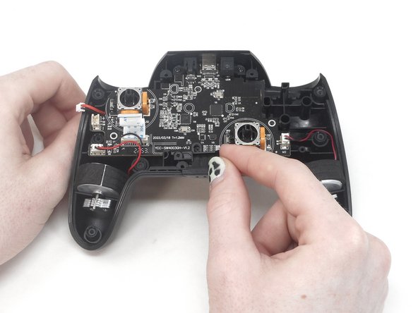

  11. YCCTEAM YCC-SW4001 Battery Replacement: crwdns2935265:011crwdnd2935265:01crwdnd2935265:03crwdne2935265:0 YCCTEAM YCC-SW4001 Battery Replacement: crwdns2935265:011crwdnd2935265:02crwdnd2935265:03crwdne2935265:0 YCCTEAM YCC-SW4001 Battery Replacement: crwdns2935265:011crwdnd2935265:03crwdnd2935265:03crwdne2935265:0
    • Use a Phillips screwdriver to remove the three 7.5 mm screws that secure the motherboard.
    • Remove the player LEDs from the motherboard.

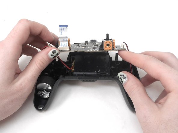

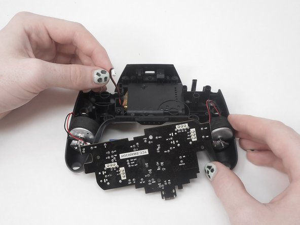

  12. YCCTEAM YCC-SW4001 Battery Replacement: crwdns2935265:012crwdnd2935265:01crwdnd2935265:03crwdne2935265:0 YCCTEAM YCC-SW4001 Battery Replacement: crwdns2935265:012crwdnd2935265:02crwdnd2935265:03crwdne2935265:0 YCCTEAM YCC-SW4001 Battery Replacement: crwdns2935265:012crwdnd2935265:03crwdnd2935265:03crwdne2935265:0
    • Gently lift the motherboard up and out of the controller and set it directly between the grips.
    • Take care not to damage the rumble motor connections.

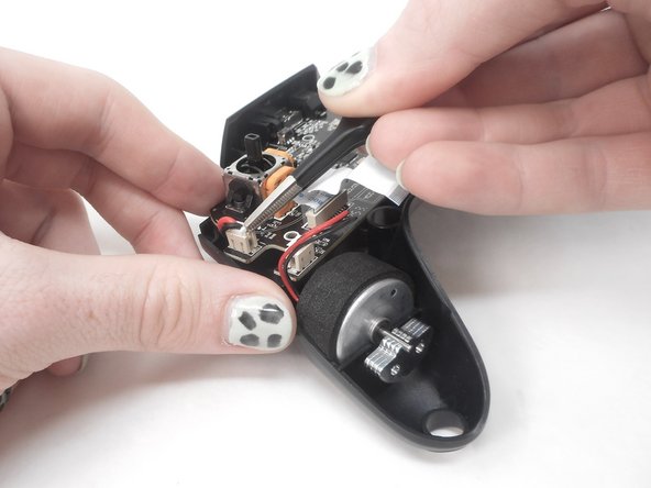

  13. YCCTEAM YCC-SW4001 Battery Replacement: crwdns2935265:013crwdnd2935265:01crwdnd2935265:01crwdne2935265:0
    • Use a spudger to gently lever the battery out of the controller.
    • The battery is attached with adhesive, so gently sever the adhesive around the entirety of the battery as you pry.
    • Take care not to puncture or bend the battery.
    • If your new battery does not come with adhesive, apply new adhesive to secure the battery.
