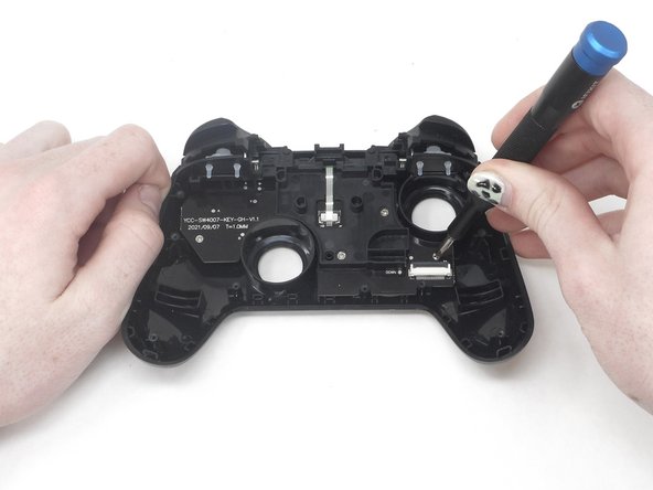

  8. YCCTEAM YCC-SW4001 ABXY Buttons Replacement: crwdns2935265:08crwdnd2935265:01crwdnd2935265:01crwdne2935265:0
    • Remove the front case.

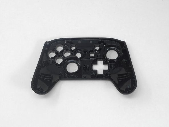

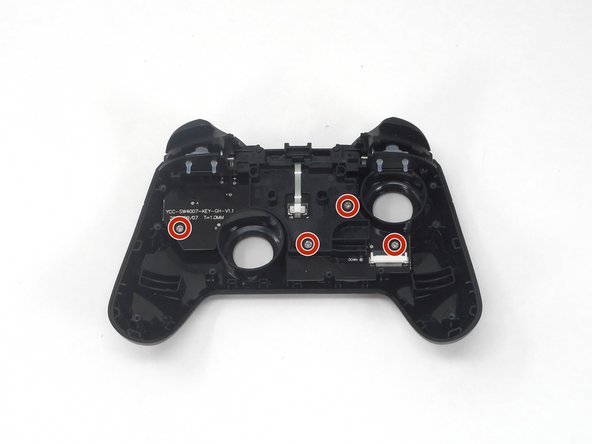

  9. YCCTEAM YCC-SW4001 ABXY Buttons Replacement, ABXY Buttons: crwdns2935265:09crwdnd2935265:01crwdnd2935265:03crwdne2935265:0 YCCTEAM YCC-SW4001 ABXY Buttons Replacement, ABXY Buttons: crwdns2935265:09crwdnd2935265:02crwdnd2935265:03crwdne2935265:0 YCCTEAM YCC-SW4001 ABXY Buttons Replacement, ABXY Buttons: crwdns2935265:09crwdnd2935265:03crwdnd2935265:03crwdne2935265:0
    • Isolate the front cover.
    • Flip over the front cover and remove the four 5.77 mm screws from the back of the front cover using the Phillips #1 Screwdriver.

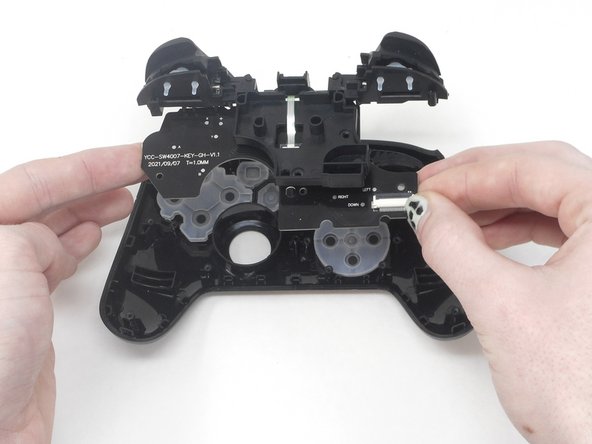

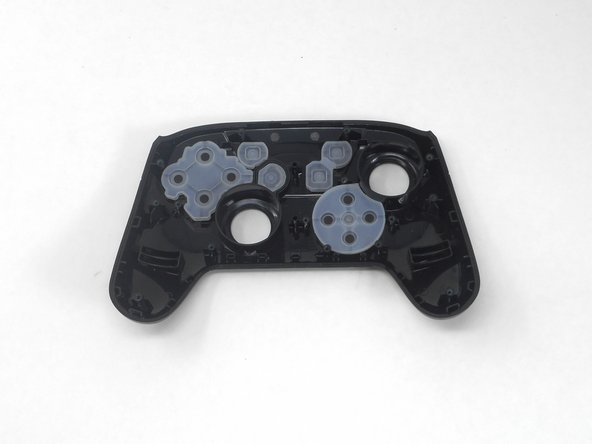

  10. YCCTEAM YCC-SW4001 ABXY Buttons Replacement: crwdns2935265:010crwdnd2935265:01crwdnd2935265:03crwdne2935265:0 YCCTEAM YCC-SW4001 ABXY Buttons Replacement: crwdns2935265:010crwdnd2935265:02crwdnd2935265:03crwdne2935265:0 YCCTEAM YCC-SW4001 ABXY Buttons Replacement: crwdns2935265:010crwdnd2935265:03crwdnd2935265:03crwdne2935265:0
    • Lift the circuit board from the front cover to expose the back of the buttons.

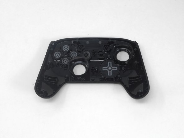

  11. YCCTEAM YCC-SW4001 ABXY Buttons Replacement: crwdns2935265:011crwdnd2935265:01crwdnd2935265:03crwdne2935265:0 YCCTEAM YCC-SW4001 ABXY Buttons Replacement: crwdns2935265:011crwdnd2935265:02crwdnd2935265:03crwdne2935265:0 YCCTEAM YCC-SW4001 ABXY Buttons Replacement: crwdns2935265:011crwdnd2935265:03crwdnd2935265:03crwdne2935265:0
    • Remove the rubber caps and the button caps by either dumping them out or taking them out by hand.
