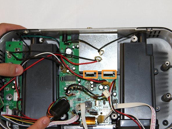

  7. XtremeMac Luna Motherboard Replacement: crwdns2935265:07crwdnd2935265:01crwdnd2935265:02crwdne2935265:0 XtremeMac Luna Motherboard Replacement: crwdns2935265:07crwdnd2935265:02crwdnd2935265:02crwdne2935265:0
    • Turn the circuit boards over. Remove the two connections on the left side by pulling on the tabs.
    • The glue that holds the connection together will come off when you pull. Pull on the tab with enough force to break the glue without damaging the wires.

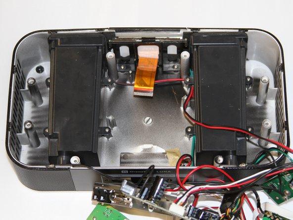

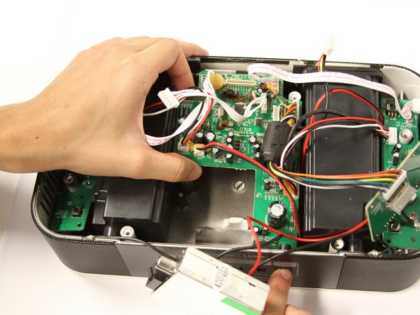

  8. XtremeMac Luna Motherboard Replacement, Motherboard: crwdns2935265:08crwdnd2935265:01crwdnd2935265:02crwdne2935265:0 XtremeMac Luna Motherboard Replacement, Motherboard: crwdns2935265:08crwdnd2935265:02crwdnd2935265:02crwdne2935265:0
    • Disconnect the white cables on the front of the radio jack.
  9. XtremeMac Luna Motherboard Replacement: crwdns2935265:09crwdnd2935265:01crwdnd2935265:03crwdne2935265:0 XtremeMac Luna Motherboard Replacement: crwdns2935265:09crwdnd2935265:02crwdnd2935265:03crwdne2935265:0 XtremeMac Luna Motherboard Replacement: crwdns2935265:09crwdnd2935265:03crwdnd2935265:03crwdne2935265:0
    • Carefully remove the radio jack from the casing by pushing on the back connections.
    • Gently remove the motherboard from the casing. Be careful with the display housing.
