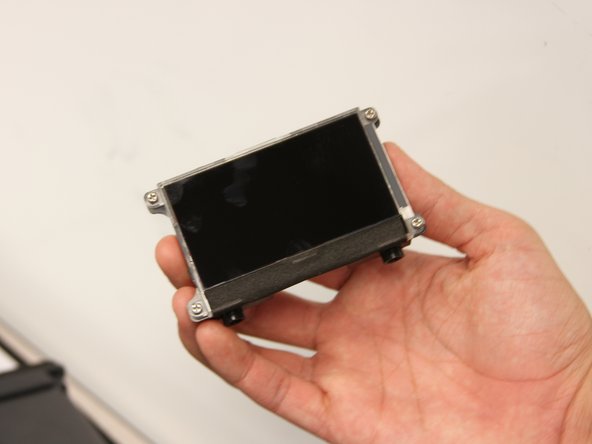

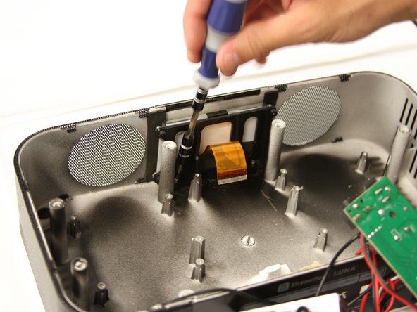

    1. XtremeMac Luna LCD Display Replacement, LCD Display: crwdns2935265:010crwdnd2935265:01crwdnd2935265:02crwdne2935265:0 XtremeMac Luna LCD Display Replacement, LCD Display: crwdns2935265:010crwdnd2935265:02crwdnd2935265:02crwdne2935265:0
      • Unscrew two 10mm silver screws at the base of the LCD screen to free it from the chassis.
    2. XtremeMac Luna LCD Display Replacement: crwdns2935265:011crwdnd2935265:01crwdnd2935265:02crwdne2935265:0 XtremeMac Luna LCD Display Replacement: crwdns2935265:011crwdnd2935265:02crwdnd2935265:02crwdne2935265:0
      • Gently pull up on the LCD screen to remove it.
