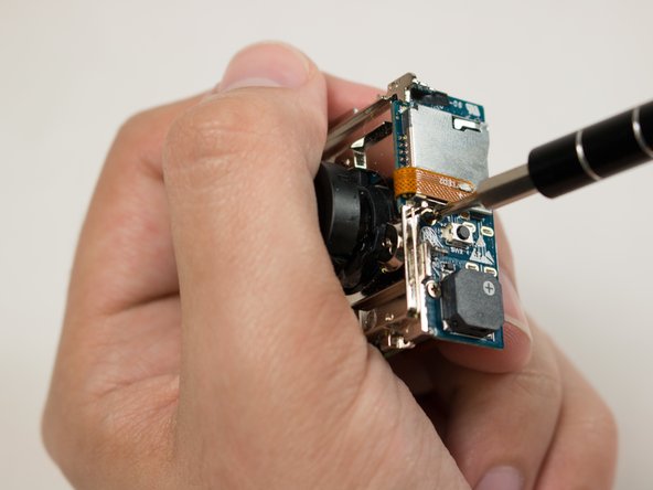

  8. Xiaomi Yi Motherboard Replacement, Motherboard: crwdns2935265:08crwdnd2935265:01crwdnd2935265:02crwdne2935265:0 Xiaomi Yi Motherboard Replacement, Motherboard: crwdns2935265:08crwdnd2935265:02crwdnd2935265:02crwdne2935265:0
    • Remove the two 3.1 mm Phillips #000 screws securing the motherboard to the chassis.
    • Be sure to support the motherboard, the ribbon cable connection can easily be damaged.

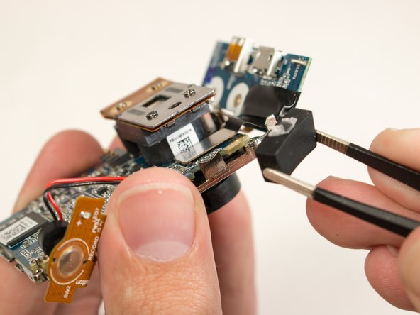

  9. Xiaomi Yi Motherboard Replacement: crwdns2935265:09crwdnd2935265:01crwdnd2935265:03crwdne2935265:0 Xiaomi Yi Motherboard Replacement: crwdns2935265:09crwdnd2935265:02crwdnd2935265:03crwdne2935265:0 Xiaomi Yi Motherboard Replacement: crwdns2935265:09crwdnd2935265:03crwdnd2935265:03crwdne2935265:0
    • Locate the rubber spacer between the image sensor and the ribbon connection for the motherboard.
    • Using the tweezers gently remove the spacer block and set aside.

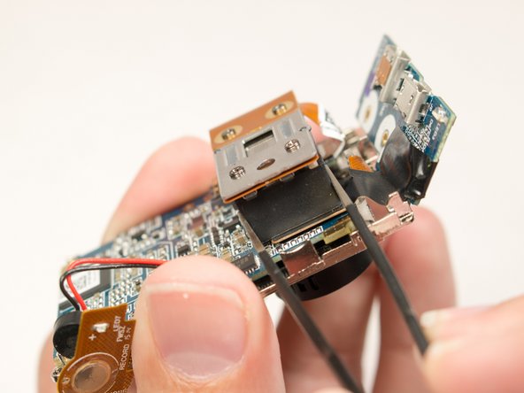

  10. Xiaomi Yi Motherboard Replacement: crwdns2935265:010crwdnd2935265:01crwdnd2935265:02crwdne2935265:0 Xiaomi Yi Motherboard Replacement: crwdns2935265:010crwdnd2935265:02crwdnd2935265:02crwdne2935265:0
    • Pry gently using the flat end of the black spudger to remove the ribbon connector.
    • Lift the lens assembly up and away from the motherboard.
    • Motherboard remains.
