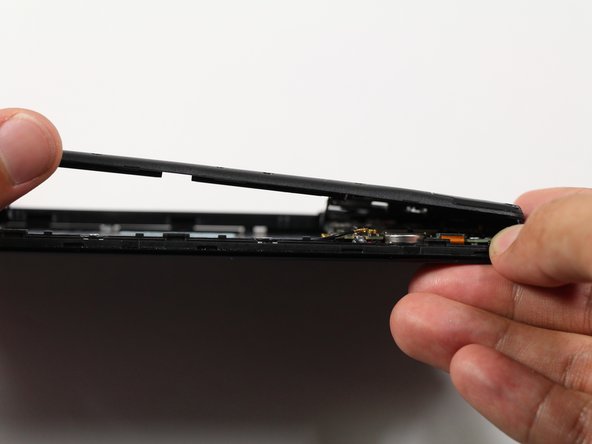

      • Run the plastic opening tool along the seam on the side of the phone to remove the rear casing.

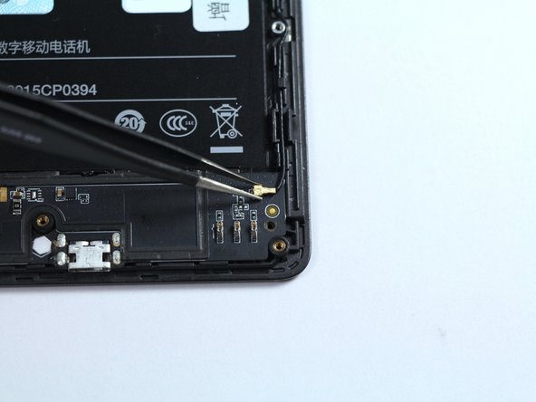

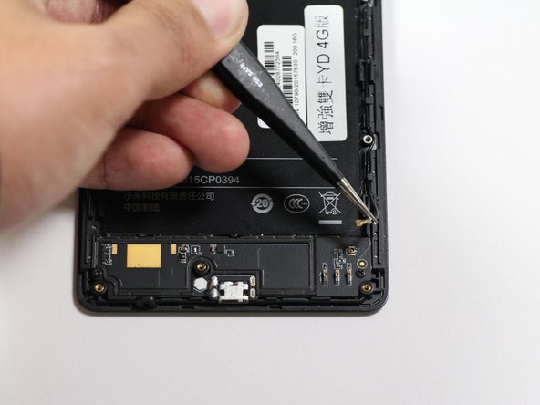

      • Locate the antenna cable at the top right corner of the charging port.
      • Lift the antenna cable off of the panel with tweezers.

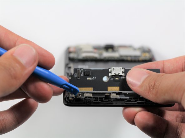

    3. Xiaomi Redmi Note Screen Replacement: crwdns2935265:08crwdnd2935265:01crwdnd2935265:03crwdne2935265:0 Xiaomi Redmi Note Screen Replacement: crwdns2935265:08crwdnd2935265:02crwdnd2935265:03crwdne2935265:0 Xiaomi Redmi Note Screen Replacement: crwdns2935265:08crwdnd2935265:03crwdnd2935265:03crwdne2935265:0
      • Flip the panel to its back side, but do not fully lift it off of the phone yet.
      • Use a plastic opening tool to gently pry off the press fit connector attached to the back side of the panel.
    4. Xiaomi Redmi Note Screen Replacement: crwdns2935265:09crwdnd2935265:01crwdnd2935265:01crwdne2935265:0
      • Lift the charging port up to remove it from the frame.

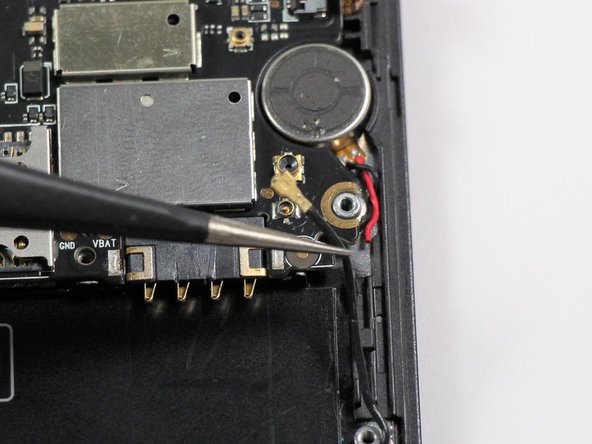

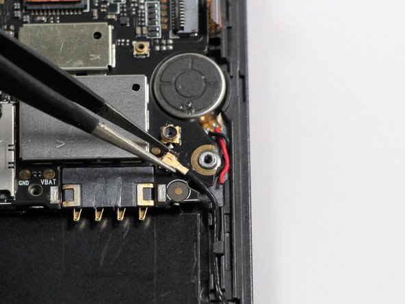

      • Locate the antenna cable on the bottom right of the motherboard and use tweezers to lift the cable off of the motherboard.

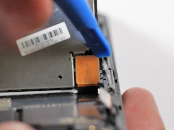

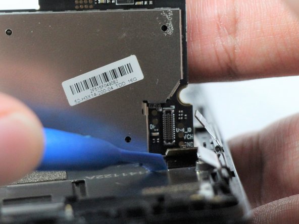

      • Flip over the motherboard to reveal the back.
      • Use a plastic opening tool to pry off the snap fit connector, located on the bottom right off of the motherboard.

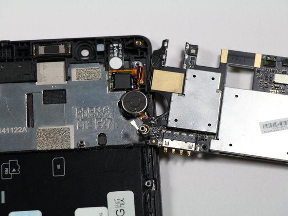

    6. Xiaomi Redmi Note Screen Replacement: crwdns2935265:017crwdnd2935265:01crwdnd2935265:02crwdne2935265:0 Xiaomi Redmi Note Screen Replacement: crwdns2935265:017crwdnd2935265:02crwdnd2935265:02crwdne2935265:0
      • Lift up the motherboard and turn it over to place it by the side of the phone.
      • Do not attempt to remove the motherboard at this stage. Pulling on the board can damage its connection to the vibrating motor.
    7. Xiaomi Redmi Note Screen Replacement: crwdns2935265:018crwdnd2935265:01crwdnd2935265:03crwdne2935265:0 Xiaomi Redmi Note Screen Replacement: crwdns2935265:018crwdnd2935265:02crwdnd2935265:03crwdne2935265:0 Xiaomi Redmi Note Screen Replacement: crwdns2935265:018crwdnd2935265:03crwdnd2935265:03crwdne2935265:0
      • Use tweezers to peel the vibrating motor off the frame of the phone.
      • The vibrating motor is glued to the frame, so do not be afraid to use force to dislodge it.

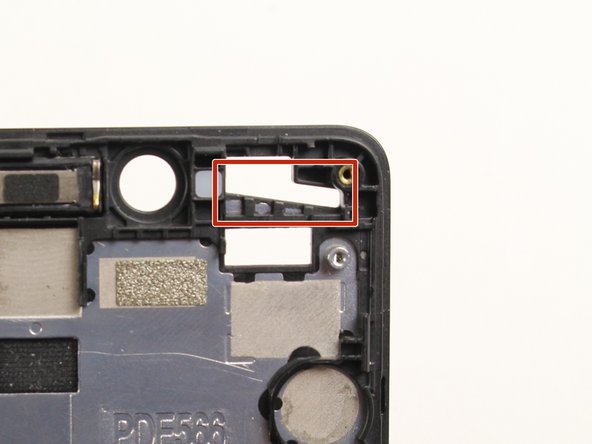

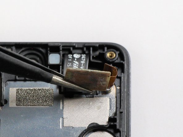

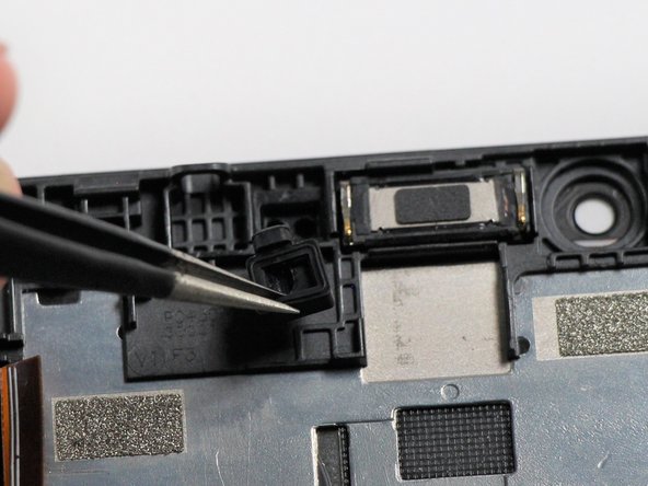

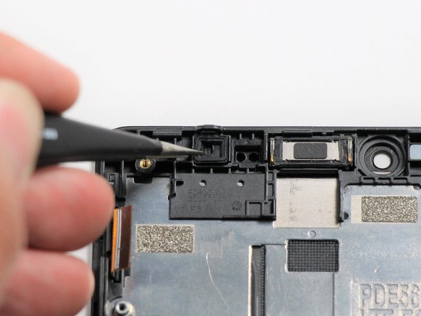

    1. Xiaomi Redmi Note Screen Replacement, Screen: crwdns2935265:019crwdnd2935265:01crwdnd2935265:03crwdne2935265:0 Xiaomi Redmi Note Screen Replacement, Screen: crwdns2935265:019crwdnd2935265:02crwdnd2935265:03crwdne2935265:0 Xiaomi Redmi Note Screen Replacement, Screen: crwdns2935265:019crwdnd2935265:03crwdnd2935265:03crwdne2935265:0

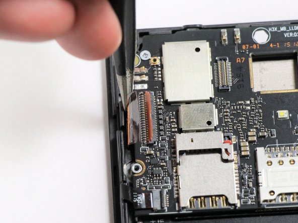

      • Use tweezers to pull out the rubber proximity sensor from the top left of the frame

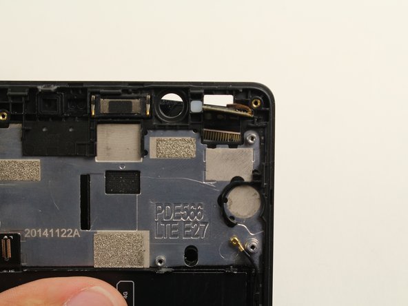

    2. Xiaomi Redmi Note Screen Replacement: crwdns2935265:020crwdnd2935265:01crwdnd2935265:02crwdne2935265:0 Xiaomi Redmi Note Screen Replacement: crwdns2935265:020crwdnd2935265:02crwdnd2935265:02crwdne2935265:0
      • Use tweezers to peel off the screen ribbon cable from the frame.
      • Do not be afraid to use a bit of force as the ribbon cable is glued onto the frame.

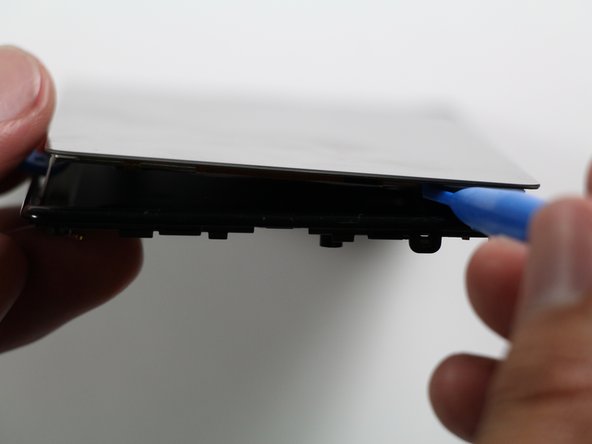

    4. Xiaomi Redmi Note Screen Replacement: crwdns2935265:022crwdnd2935265:01crwdnd2935265:01crwdne2935265:0
      • Slightly flex the frame to insert a plastic prying tool between the screen and the frame.
    5. Xiaomi Redmi Note Screen Replacement: crwdns2935265:023crwdnd2935265:01crwdnd2935265:02crwdne2935265:0 Xiaomi Redmi Note Screen Replacement: crwdns2935265:023crwdnd2935265:02crwdnd2935265:02crwdne2935265:0
      • Run the plastic opening tool around the seam between the screen and the frame until an opening can be seen.
    6. Xiaomi Redmi Note Screen Replacement: crwdns2935265:024crwdnd2935265:01crwdnd2935265:03crwdne2935265:0 Xiaomi Redmi Note Screen Replacement: crwdns2935265:024crwdnd2935265:02crwdnd2935265:03crwdne2935265:0 Xiaomi Redmi Note Screen Replacement: crwdns2935265:024crwdnd2935265:03crwdnd2935265:03crwdne2935265:0
      • Place a finger into the opening and continue peeling away the screen from the frame.
      • If the screen is cracked, avoid touching it. Instead, peel up from the metal underside of the screen to avoid getting cut.
      • Watch out for the ribbon cable that is fed through an opening in the top right corner of the frame. The screen will not come out unless the cable fits through the opening.
