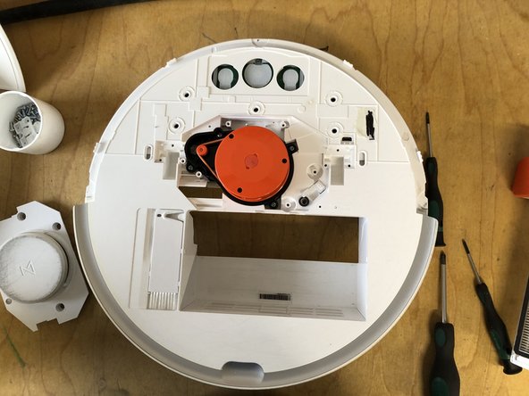

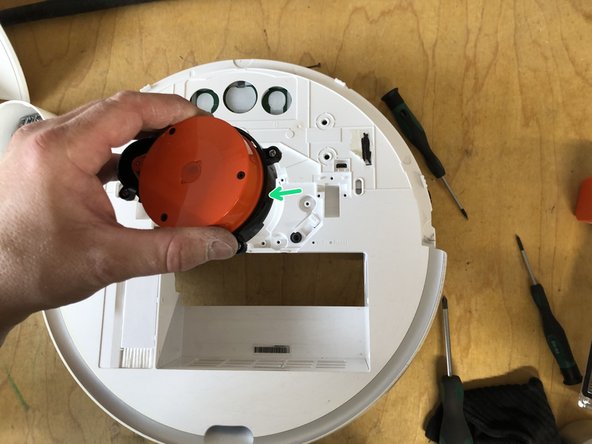

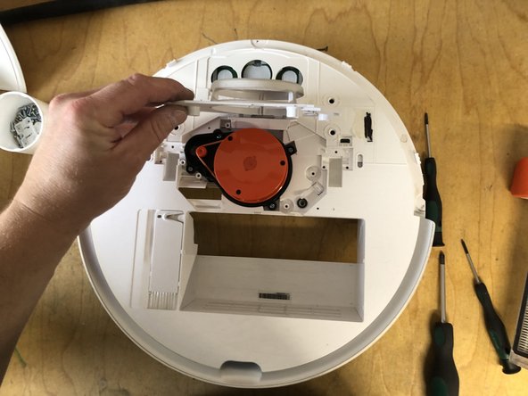

  5. Xiaomi ROBOROCK S50200 complete disassembly, Removing the laser cover: crwdns2935265:05crwdnd2935265:01crwdnd2935265:03crwdne2935265:0 Xiaomi ROBOROCK S50200 complete disassembly, Removing the laser cover: crwdns2935265:05crwdnd2935265:02crwdnd2935265:03crwdne2935265:0 Xiaomi ROBOROCK S50200 complete disassembly, Removing the laser cover: crwdns2935265:05crwdnd2935265:03crwdnd2935265:03crwdne2935265:0
    • Remove the 5 screws for the cover
    • Remove the cover upwards
  6. Xiaomi ROBOROCK S50200 complete disassembly: crwdns2935265:06crwdnd2935265:01crwdnd2935265:02crwdne2935265:0 Xiaomi ROBOROCK S50200 complete disassembly: crwdns2935265:06crwdnd2935265:02crwdnd2935265:02crwdne2935265:0
    • Remove the 4 screws of the laser unit
    • Remove the unit upwards (unit is still plugged into the circuit board)

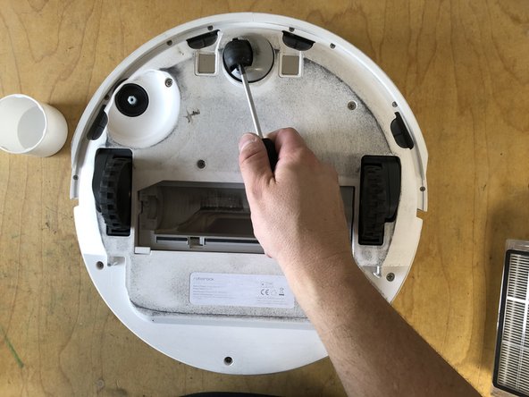

  8. Xiaomi ROBOROCK S50200 complete disassembly, Removing the side brush: crwdns2935265:08crwdnd2935265:01crwdnd2935265:03crwdne2935265:0 Xiaomi ROBOROCK S50200 complete disassembly, Removing the side brush: crwdns2935265:08crwdnd2935265:02crwdnd2935265:03crwdne2935265:0 Xiaomi ROBOROCK S50200 complete disassembly, Removing the side brush: crwdns2935265:08crwdnd2935265:03crwdnd2935265:03crwdne2935265:0
    • Remove the screw holding the side brush.
    • You don't need to completely unscrew the screw; simply loosen it and remove it with the brush.
    • Remove the side brush along with the screw by lifting it upward.
  9. Xiaomi ROBOROCK S50200 complete disassembly, Removing the front wheel.: crwdns2935265:09crwdnd2935265:01crwdnd2935265:03crwdne2935265:0 Xiaomi ROBOROCK S50200 complete disassembly, Removing the front wheel.: crwdns2935265:09crwdnd2935265:02crwdnd2935265:03crwdne2935265:0 Xiaomi ROBOROCK S50200 complete disassembly, Removing the front wheel.: crwdns2935265:09crwdnd2935265:03crwdnd2935265:03crwdne2935265:0
    • Lift the front wheel with the screwdriver.
    • Completely pull the front wheel upward to remove it.

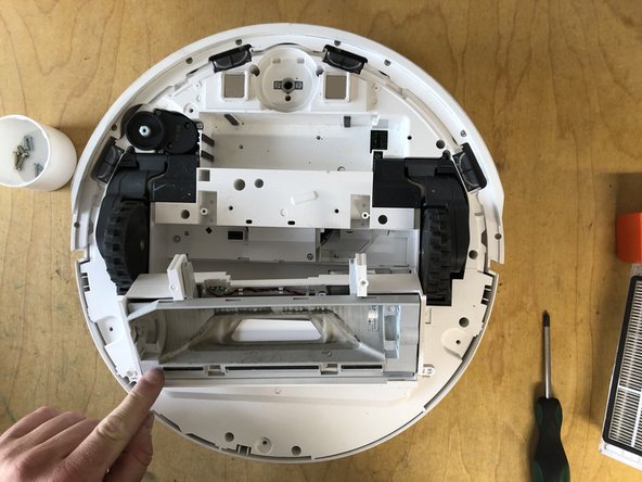

  12. Xiaomi ROBOROCK S50200 complete disassembly, Remove the main brush assembly: crwdns2935265:012crwdnd2935265:01crwdnd2935265:03crwdne2935265:0 Xiaomi ROBOROCK S50200 complete disassembly, Remove the main brush assembly: crwdns2935265:012crwdnd2935265:02crwdnd2935265:03crwdne2935265:0 Xiaomi ROBOROCK S50200 complete disassembly, Remove the main brush assembly: crwdns2935265:012crwdnd2935265:03crwdnd2935265:03crwdne2935265:0
    • Remove the four screws from the main brush assembly
    • Lift out the main brush assembly upwards

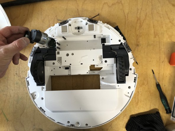

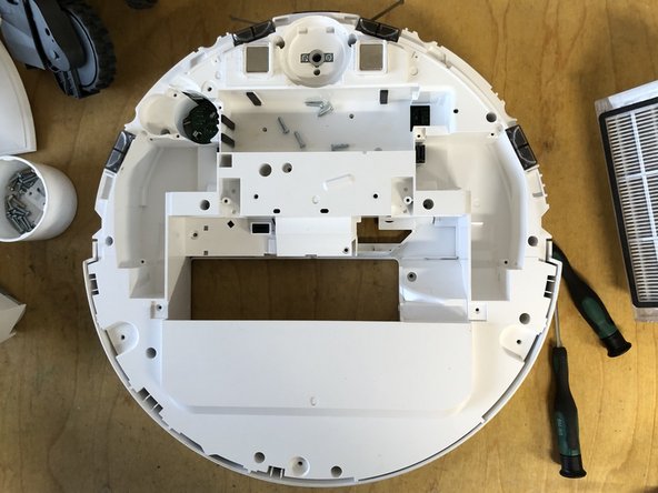

  14. Xiaomi ROBOROCK S50200 complete disassembly, Side-brush motor: crwdns2935265:014crwdnd2935265:01crwdnd2935265:03crwdne2935265:0 Xiaomi ROBOROCK S50200 complete disassembly, Side-brush motor: crwdns2935265:014crwdnd2935265:02crwdnd2935265:03crwdne2935265:0 Xiaomi ROBOROCK S50200 complete disassembly, Side-brush motor: crwdns2935265:014crwdnd2935265:03crwdnd2935265:03crwdne2935265:0
    • Remove the three screws from the motor
    • Pull the motor out upwards (plug connection with the circuit board)

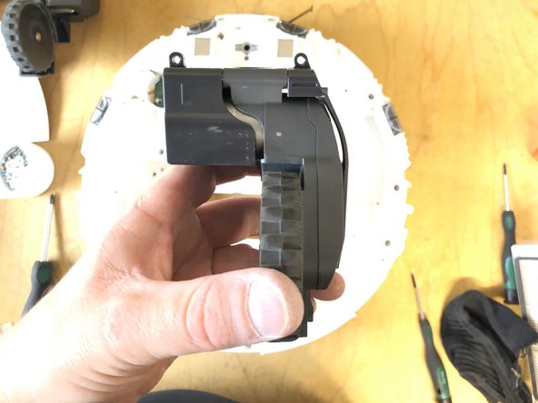

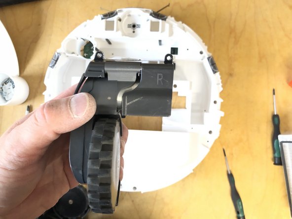

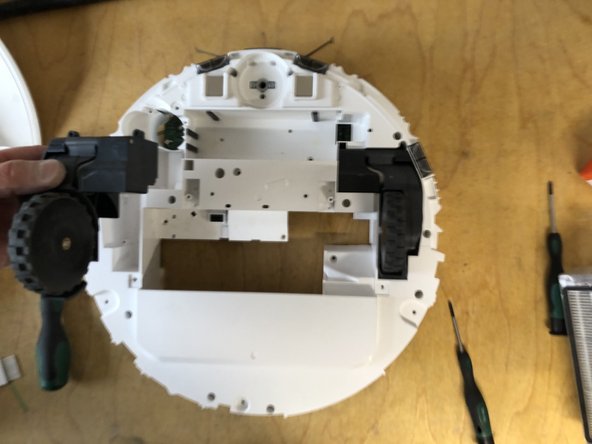

  15. Xiaomi ROBOROCK S50200 complete disassembly, Remove the left wheel drive unit: crwdns2935265:015crwdnd2935265:01crwdnd2935265:03crwdne2935265:0 Xiaomi ROBOROCK S50200 complete disassembly, Remove the left wheel drive unit: crwdns2935265:015crwdnd2935265:02crwdnd2935265:03crwdne2935265:0 Xiaomi ROBOROCK S50200 complete disassembly, Remove the left wheel drive unit: crwdns2935265:015crwdnd2935265:03crwdnd2935265:03crwdne2935265:0
    • remove the three screws from the drive unit
    • Remove wheel upwards (connected to a circuit board via plug connection)

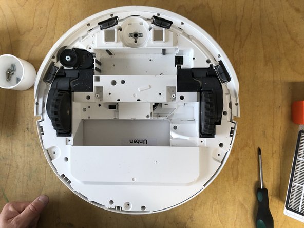

  16. Xiaomi ROBOROCK S50200 complete disassembly, Right wheel: crwdns2935265:016crwdnd2935265:01crwdnd2935265:03crwdne2935265:0 Xiaomi ROBOROCK S50200 complete disassembly, Right wheel: crwdns2935265:016crwdnd2935265:02crwdnd2935265:03crwdne2935265:0 Xiaomi ROBOROCK S50200 complete disassembly, Right wheel: crwdns2935265:016crwdnd2935265:03crwdnd2935265:03crwdne2935265:0
    • Remove the three screws from the drive unit
    • Remove the wheel upwards (connected to the circuit board via a plug connection)

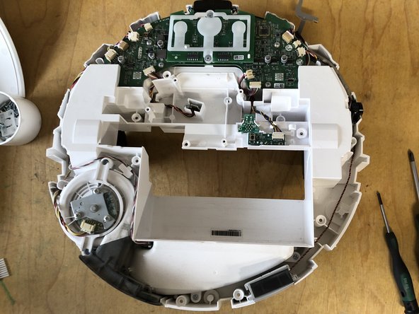

  17. Xiaomi ROBOROCK S50200 complete disassembly, Remove the top cover: crwdns2935265:017crwdnd2935265:01crwdnd2935265:02crwdne2935265:0 Xiaomi ROBOROCK S50200 complete disassembly, Remove the top cover: crwdns2935265:017crwdnd2935265:02crwdnd2935265:02crwdne2935265:0
    • Remove the 17 screws on the underside
    • Lift the cover upwards
