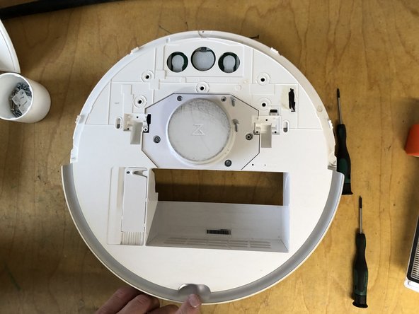

  3. Xiaomi ROBOROCK S50200 Top disassembly, Remove the front cover: crwdns2935265:03crwdnd2935265:01crwdnd2935265:02crwdne2935265:0 Xiaomi ROBOROCK S50200 Top disassembly, Remove the front cover: crwdns2935265:03crwdnd2935265:02crwdnd2935265:02crwdne2935265:0
    • Insert the spudger from the side
    • Release the clips by turning the spudger
    • Lift the cover upwards
    • These pictures show the front bumper already removed. This is not necessary for these instructions.
  4. Xiaomi ROBOROCK S50200 Top disassembly, Remove the dust container flap: crwdns2935265:04crwdnd2935265:01crwdnd2935265:03crwdne2935265:0 Xiaomi ROBOROCK S50200 Top disassembly, Remove the dust container flap: crwdns2935265:04crwdnd2935265:02crwdnd2935265:03crwdne2935265:0 Xiaomi ROBOROCK S50200 Top disassembly, Remove the dust container flap: crwdns2935265:04crwdnd2935265:03crwdnd2935265:03crwdne2935265:0
    • Loosen the 6 screws for the hinges
    • Lift and remove the hinges
    • Remove the flap upwards
Work through the steps in reverse order to reassemble your device.
