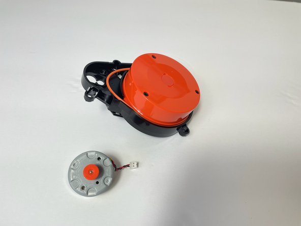

    • Turn the Laser Distance Sensor over so the backside is facing up.
    • Squeeze the tab against the connector, and pull the connector straight up from the socket to disconnect the power cable.
  7. Xiaomi ROBOROCK S5 Laser Distance Sensor Motor Replacement: crwdns2935265:07crwdnd2935265:01crwdnd2935265:03crwdne2935265:0 Xiaomi ROBOROCK S5 Laser Distance Sensor Motor Replacement: crwdns2935265:07crwdnd2935265:02crwdnd2935265:03crwdne2935265:0 Xiaomi ROBOROCK S5 Laser Distance Sensor Motor Replacement: crwdns2935265:07crwdnd2935265:03crwdnd2935265:03crwdne2935265:0
    • Turn the Laser Distance Sensor housing back over.
    • Use a spudger to detach the plastic cord from the motor that connects it to the laser.
    • Use a Phillips #1 screwdriver to remove the two 4 mm screws attaching the motor to the housing.
  8. Xiaomi ROBOROCK S5 Laser Distance Sensor Motor Replacement: crwdns2935265:08crwdnd2935265:01crwdnd2935265:02crwdne2935265:0 Xiaomi ROBOROCK S5 Laser Distance Sensor Motor Replacement: crwdns2935265:08crwdnd2935265:02crwdnd2935265:02crwdne2935265:0
    • Slide the orange gear out of the housing to remove it.
