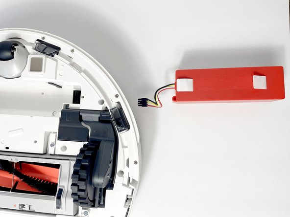

    • Lift the battery out by the two tabs on top and set it beside the robot vacuum.
    • The battery will still be attached to the robot vacuum at this point.

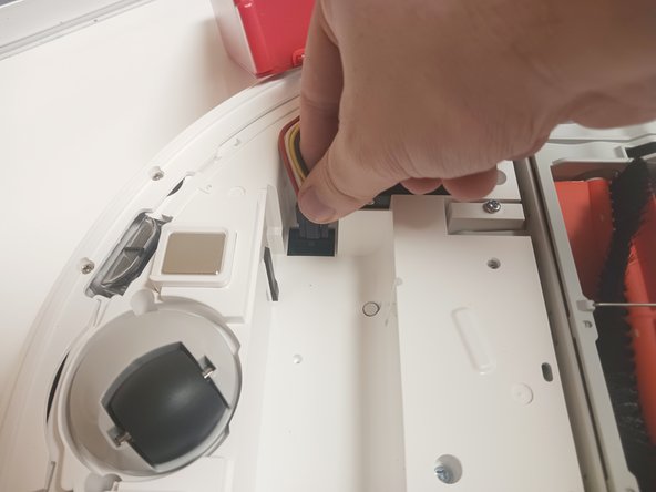

    • Disconnect the battery from the robot vacuum by squeezing and pulling the plug connector from the board.
