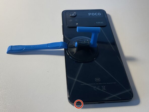

    • Shutdown the device
    • Remove the SIM card carriage by pushing the SIM eject tool or a bent paperclip into the SIM eject hole
    • Apply the suction cup to the left side of the back panel, slightly below the power button
    • Insert the Opening Tool between the glass and the frame, orienting it as shown in the picture
    • Once you are positioned between the back panel and the frame, gently work the tool counterclockwise to lift the back panel away from the adhesive. If the adhesive is too strong, carefully heat the area with a hair dryer or hot air gun, or insert the Jimmy approximately 5 mm to cut through the tape
    • Once the back panel is separated, remove the remaining adhesive from both the phone and the back panel

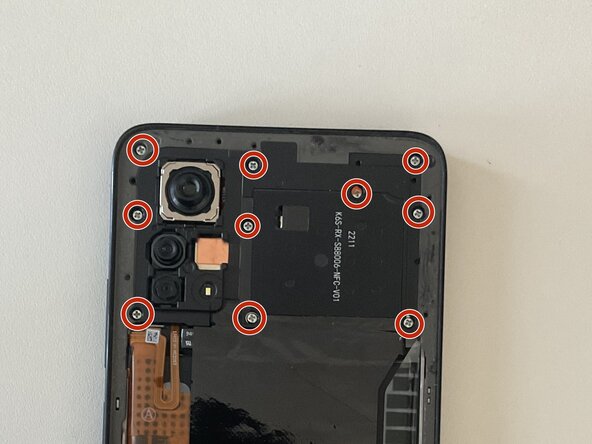

  2. Xiaomi Poco X4 Pro 5G USB C Port Replacement, Remove the screws: crwdns2935265:02crwdnd2935265:01crwdnd2935265:02crwdne2935265:0 Xiaomi Poco X4 Pro 5G USB C Port Replacement, Remove the screws: crwdns2935265:02crwdnd2935265:02crwdnd2935265:02crwdne2935265:0
    • Place the phone screen down
    • Remove the 10 Phillips #00 screws in the top half
    • Remove the 8 Phillips #00 screws in the bottom half
    • One or more screws may be covered by warranty seals
    • In the pictured device, the warranty seal was an orange dot on the middle screw to the right of the camera module. All screws are marked to account for variations in seal placement.
