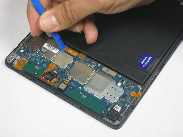

    • Remove the two 3.0 mm Phillips #00 screws securing the motherboard to the device.
  6. Xiaomi Mi Pad Motherboard Replacement: crwdns2935265:06crwdnd2935265:01crwdnd2935265:02crwdne2935265:0 Xiaomi Mi Pad Motherboard Replacement: crwdns2935265:06crwdnd2935265:02crwdnd2935265:02crwdne2935265:0
    • Disconnect the six ribbon cables attached to the motherboard using a plastic opening tool.
  7. Xiaomi Mi Pad Motherboard Replacement: crwdns2935265:07crwdnd2935265:01crwdnd2935265:01crwdne2935265:0
    • Carefully remove the motherboard from the device.
