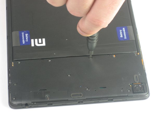

    1. Xiaomi Mi Pad Front Camera  Replacement, Front Camera: crwdns2935265:03crwdnd2935265:01crwdnd2935265:02crwdne2935265:0 Xiaomi Mi Pad Front Camera  Replacement, Front Camera: crwdns2935265:03crwdnd2935265:02crwdnd2935265:02crwdne2935265:0
      • Remove the twelve 3.0 mm Phillips #000 screws on the upper cover of the device.
    2. Xiaomi Mi Pad Front Camera  Replacement: crwdns2935265:04crwdnd2935265:01crwdnd2935265:01crwdne2935265:0
      • Remove the upper cover from the device.
    3. Xiaomi Mi Pad Front Camera  Replacement: crwdns2935265:05crwdnd2935265:01crwdnd2935265:01crwdne2935265:0
      • Use a plastic opening tool to gently disconnect the front-facing camera from the motherboard.
    4. Xiaomi Mi Pad Front Camera  Replacement: crwdns2935265:06crwdnd2935265:01crwdnd2935265:01crwdne2935265:0
      • Carefully remove the front camera from the device.
