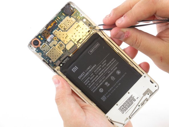

    2. Xiaomi Mi Note Rear camera Replacement: crwdns2935265:06crwdnd2935265:01crwdnd2935265:02crwdne2935265:0 Xiaomi Mi Note Rear camera Replacement: crwdns2935265:06crwdnd2935265:02crwdnd2935265:02crwdne2935265:0
      • Use tweezers to detach the small ribbon on the left side located near the volume buttons as well as the microphone cord located on the right side along the frame.
      • When detaching the ribbon on the left use minimal force to prevent damage.

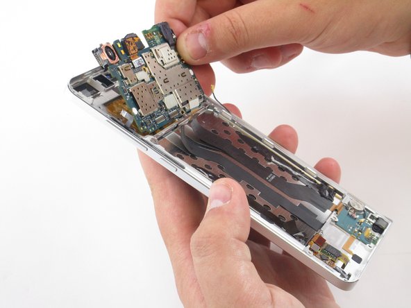

    3. Xiaomi Mi Note Rear camera Replacement: crwdns2935265:07crwdnd2935265:01crwdnd2935265:02crwdne2935265:0 Xiaomi Mi Note Rear camera Replacement: crwdns2935265:07crwdnd2935265:02crwdnd2935265:02crwdne2935265:0
      • Use a tweezer to lift and remove the motherboard from the frame.
      • Be sure that the Dual SIM card and tray has been removed.
