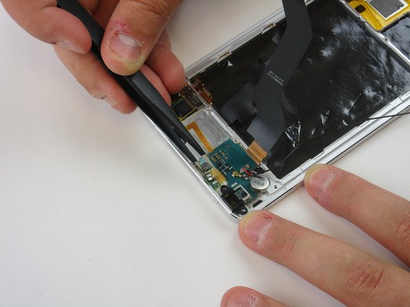

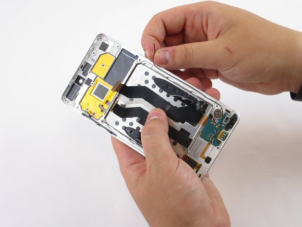

    • Use tweezers to pull upwards and detach the microphone wire that connects the motherboard to the dock connector.
  6. Xiaomi Mi Note Micro USB/Microphone/Virtual Keys light/Vibrator Replacement: crwdns2935265:06crwdnd2935265:01crwdnd2935265:01crwdne2935265:0
    • Peel back the ribbon that is adhered to the metal surface as shown.
  7. Xiaomi Mi Note Micro USB/Microphone/Virtual Keys light/Vibrator Replacement: crwdns2935265:07crwdnd2935265:01crwdnd2935265:03crwdne2935265:0 Xiaomi Mi Note Micro USB/Microphone/Virtual Keys light/Vibrator Replacement: crwdns2935265:07crwdnd2935265:02crwdnd2935265:03crwdne2935265:0 Xiaomi Mi Note Micro USB/Microphone/Virtual Keys light/Vibrator Replacement: crwdns2935265:07crwdnd2935265:03crwdnd2935265:03crwdne2935265:0
    • The dock connector is firmly adhered to the frame below it. To prevent damage to the phone use minimal force when removing.
    • Using tweezers slowly start prying upwards at the locations shown in the images. After carefully prying around the edges of the dock connector, it can now lifted upwards out of the frame.
