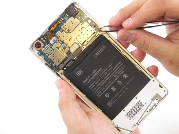

    1. Xiaomi Mi Note Front camera Replacement, Front camera: crwdns2935265:07crwdnd2935265:01crwdnd2935265:01crwdne2935265:0
      • Use a spudger to pry upwards and detach the three ribbons that are connected to the motherboard.
    2. Xiaomi Mi Note Front camera Replacement: crwdns2935265:08crwdnd2935265:01crwdnd2935265:02crwdne2935265:0 Xiaomi Mi Note Front camera Replacement: crwdns2935265:08crwdnd2935265:02crwdnd2935265:02crwdne2935265:0
      • Use tweezers to detach the small ribbon on left side located near the volume buttons using an upwards prying motion.
      • You will also need to detach the microphone cord located on the right side along the frame using an upwards prying motion as well.
      • When detaching the ribbon on the left use minimal force to prevent damage.

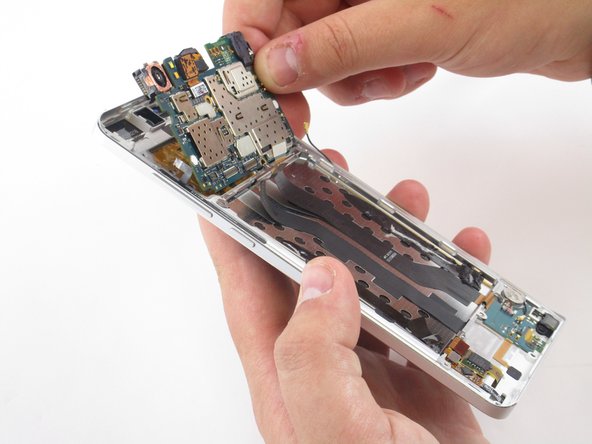

    3. Xiaomi Mi Note Front camera Replacement: crwdns2935265:09crwdnd2935265:01crwdnd2935265:02crwdne2935265:0 Xiaomi Mi Note Front camera Replacement: crwdns2935265:09crwdnd2935265:02crwdnd2935265:02crwdne2935265:0
      • Use a tweezer to lift and remove the motherboard from the frame.
      • Be sure that the Dual SIM card and tray has been removed.
    4. Xiaomi Mi Note Front camera Replacement: crwdns2935265:010crwdnd2935265:01crwdnd2935265:01crwdne2935265:0
      • The front camera is attached to the motherboard by a ribbon, use tweezers to detach it from the motherboard.
