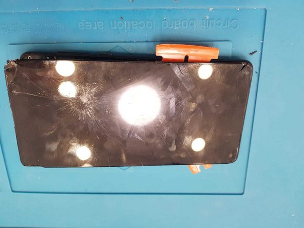

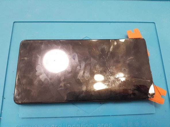

  6. Xiaomi Mi Mix 2s Screen (LCD+Touch) Replacement: crwdns2935265:06crwdnd2935265:01crwdnd2935265:03crwdne2935265:0 Xiaomi Mi Mix 2s Screen (LCD+Touch) Replacement: crwdns2935265:06crwdnd2935265:02crwdnd2935265:03crwdne2935265:0 Xiaomi Mi Mix 2s Screen (LCD+Touch) Replacement: crwdns2935265:06crwdnd2935265:03crwdnd2935265:03crwdne2935265:0
    • Carefully start to separate the screen as shown. Start from the top corner.
