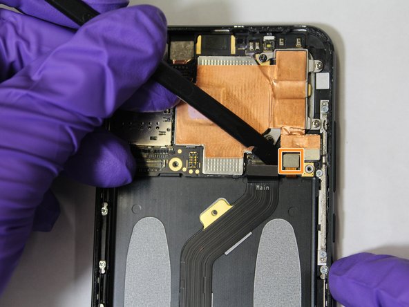

    • Using a plastic spudger and plastic tipped tweezers, carefully peal back the adhered copper sheeting from the back of the rear cameras.

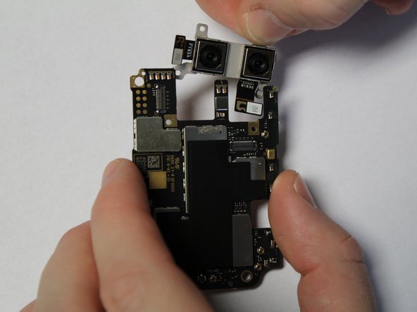

    • Using a plastic spudger, gently separate the two rear camera ribbon cables from the motherboard.
    • Gently remove the rear cameras from the motherboard.
