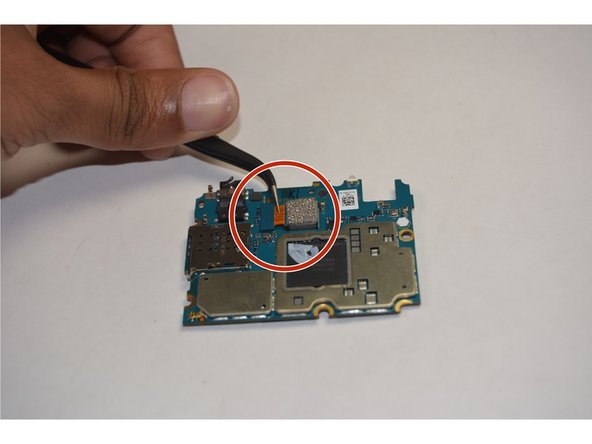

  8. Xiaomi Mi 4 Rear Facing Camera Replacement, Rear Facing Camera: crwdns2935265:08crwdnd2935265:01crwdnd2935265:02crwdne2935265:0 Xiaomi Mi 4 Rear Facing Camera Replacement, Rear Facing Camera: crwdns2935265:08crwdnd2935265:02crwdnd2935265:02crwdne2935265:0
    • With the motherboard removed from the device, turn the motherboard over to face the obverse side.
    • Locate the connector for the rear camera.

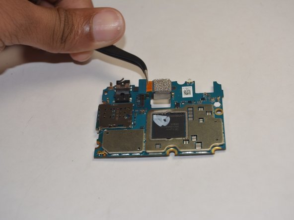

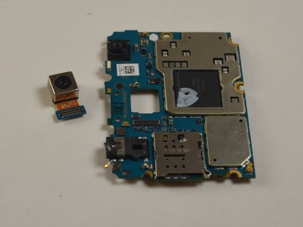

  9. Xiaomi Mi 4 Rear Facing Camera Replacement: crwdns2935265:09crwdnd2935265:01crwdnd2935265:03crwdne2935265:0 Xiaomi Mi 4 Rear Facing Camera Replacement: crwdns2935265:09crwdnd2935265:02crwdnd2935265:03crwdne2935265:0 Xiaomi Mi 4 Rear Facing Camera Replacement: crwdns2935265:09crwdnd2935265:03crwdnd2935265:03crwdne2935265:0
    • Grasp the cable with the tweezers and gently pull up and away from the motherboard to disconnect it.
