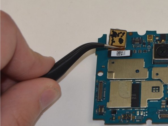

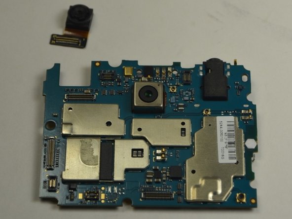

  8. Xiaomi Mi 4 Front Facing Camera Replacement, Front Facing Camera: crwdns2935265:08crwdnd2935265:01crwdnd2935265:03crwdne2935265:0 Xiaomi Mi 4 Front Facing Camera Replacement, Front Facing Camera: crwdns2935265:08crwdnd2935265:02crwdnd2935265:03crwdne2935265:0 Xiaomi Mi 4 Front Facing Camera Replacement, Front Facing Camera: crwdns2935265:08crwdnd2935265:03crwdnd2935265:03crwdne2935265:0
    • With the motherboard detached from the phone, locate the front camera in the upper left-hand corner.
    • Use a pair of tweezers to disconnect the front-facing camera by popping the cable off of the motherboard connector.
