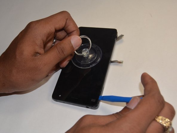

  8. Xiaomi Mi 4 Display Assembly Replacement, Display Assembly: crwdns2935265:08crwdnd2935265:01crwdnd2935265:02crwdne2935265:0 Xiaomi Mi 4 Display Assembly Replacement, Display Assembly: crwdns2935265:08crwdnd2935265:02crwdnd2935265:02crwdne2935265:0
    • After removing your device's back cover, battery, and motherboard, turn your phone over to start removing the LCD screen.
    • Start by fixing the suction cup firmly on the screen. Then wedge a plastic opening tool around the perimeter of the screen while maintaining a pulling force on the suction cup.
  9. Xiaomi Mi 4 Display Assembly Replacement: crwdns2935265:09crwdnd2935265:01crwdnd2935265:02crwdne2935265:0 Xiaomi Mi 4 Display Assembly Replacement: crwdns2935265:09crwdnd2935265:02crwdnd2935265:02crwdne2935265:0
    • Once you have pulled the screen completely off the device, there will be a ribbon wire that you previously detached from the motherboard that can be pulled gently through a hole.
    • Make sure you carefully dispose of the LCD screen if it is cracked in any way as to not be cut from the glass shards it may contain

This guide is completely useless. It skip passages like how to deal with the flash module, some ribbon cables to disconnect from the motherboard, the antenna, and most important of all, IT DOES NOT TELL YOU THAT YOU NEED A HEAT GUN FOR THE SCREEN REMOVAL. Terrible guide.
