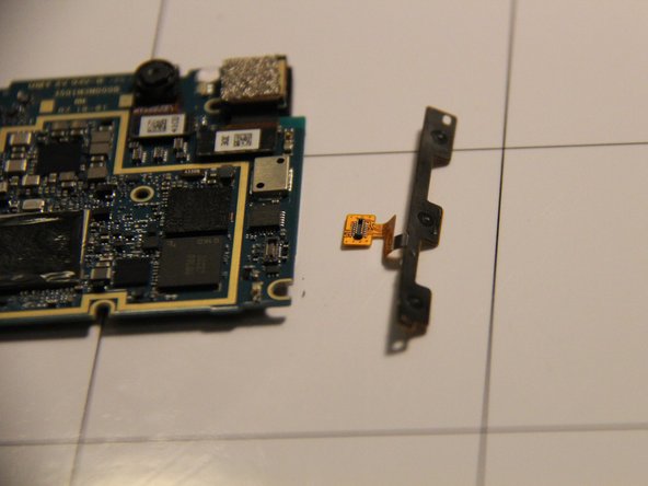

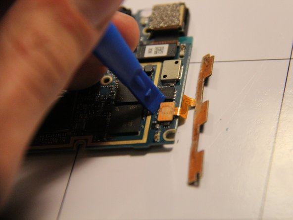

  23. Xiaomi Mi 3 Side control buttons Replacement, Side control buttons: crwdns2935265:023crwdnd2935265:01crwdnd2935265:03crwdne2935265:0 Xiaomi Mi 3 Side control buttons Replacement, Side control buttons: crwdns2935265:023crwdnd2935265:02crwdnd2935265:03crwdne2935265:0 Xiaomi Mi 3 Side control buttons Replacement, Side control buttons: crwdns2935265:023crwdnd2935265:03crwdnd2935265:03crwdne2935265:0
    • With the motherboard removed flip it over onto its front and use a small pry tool to gently disconnect the side buttons from the back of the motherboard.
