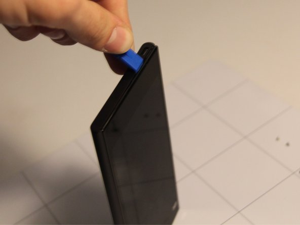

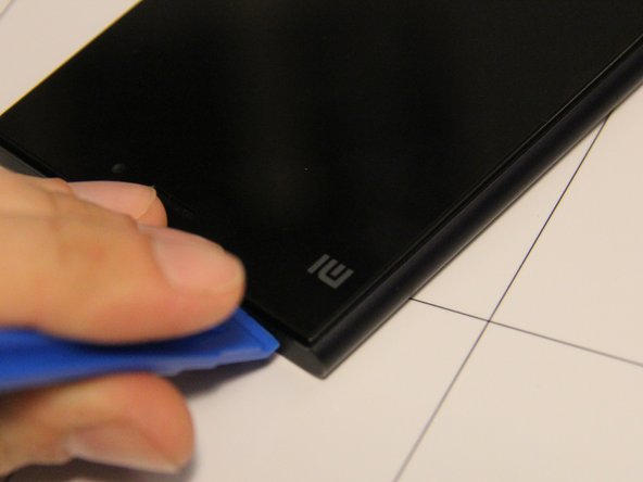

    • Insert a pry tool into the upper edge of the phone, where there is a small gap between screen and frame of the phone to begin separating the screen from the rest of the phone.
    • Be careful when using the pry tool as it can damage the phone's screen or other components.
  4. Xiaomi Mi 3 Rear Facing Camera Replacement: crwdns2935265:04crwdnd2935265:01crwdnd2935265:03crwdne2935265:0 Xiaomi Mi 3 Rear Facing Camera Replacement: crwdns2935265:04crwdnd2935265:02crwdnd2935265:03crwdne2935265:0 Xiaomi Mi 3 Rear Facing Camera Replacement: crwdns2935265:04crwdnd2935265:03crwdnd2935265:03crwdne2935265:0
    • Once the pry tool has been inserted into the phone, slide it around the perimeter of the phone while gently lifting until the screen panel and back panel of the phone separate.

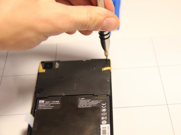

    • Place the front panel screen side down with the camera at the top.
    • Remove these six Phillips head screws located at the upper half of the phone.
    • This screw is located under an orange sticker at the top right corner of the panel. The sticker can be removed with a pair of tweezers, then remove that Phillips head screw.

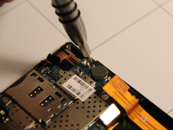

  7. Xiaomi Mi 3 Rear Facing Camera Replacement: crwdns2935265:07crwdnd2935265:01crwdnd2935265:01crwdne2935265:0
    • Next, remove these three screws located at the bottom of the back panel.

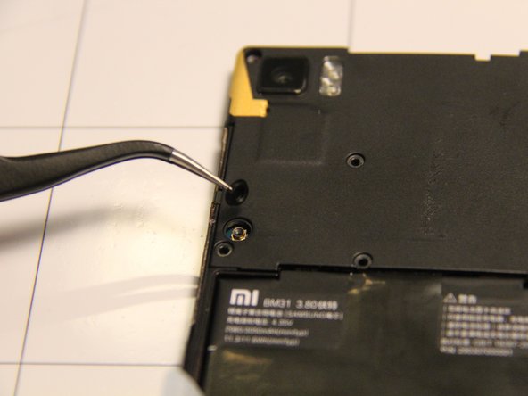

    • Using tweezers, remove the rubber dust cover on the back panel of the phone.

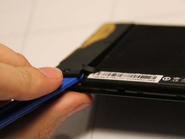

    • Remove the plastic cover on the bottom of the back panel by inserting the pry tool at the edge and gently lifting.

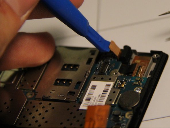

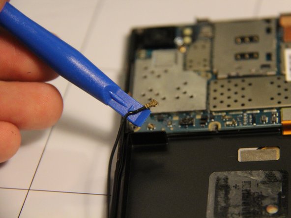

    • Disconnect the antenna wire that is attached to the lower left side of the motherboard using the pry tool.
  15. Xiaomi Mi 3 Rear Facing Camera Replacement: crwdns2935265:015crwdnd2935265:01crwdnd2935265:03crwdne2935265:0 Xiaomi Mi 3 Rear Facing Camera Replacement: crwdns2935265:015crwdnd2935265:02crwdnd2935265:03crwdne2935265:0 Xiaomi Mi 3 Rear Facing Camera Replacement: crwdns2935265:015crwdnd2935265:03crwdnd2935265:03crwdne2935265:0

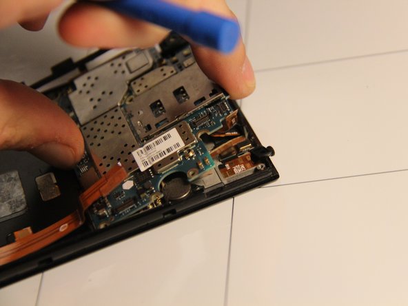

    • Use a pry tool to separate the LCD display cable from the motherboard. The cable connects to the motherboard as a rectangular metallic piece at the bottom right of the motherboard.
  16. Xiaomi Mi 3 Rear Facing Camera Replacement: crwdns2935265:016crwdnd2935265:01crwdnd2935265:02crwdne2935265:0 Xiaomi Mi 3 Rear Facing Camera Replacement: crwdns2935265:016crwdnd2935265:02crwdnd2935265:02crwdne2935265:0
    • Disconnect the gold ribbon cable for the LCD display by gently inserting the pry tool under the wide end and lifting up.

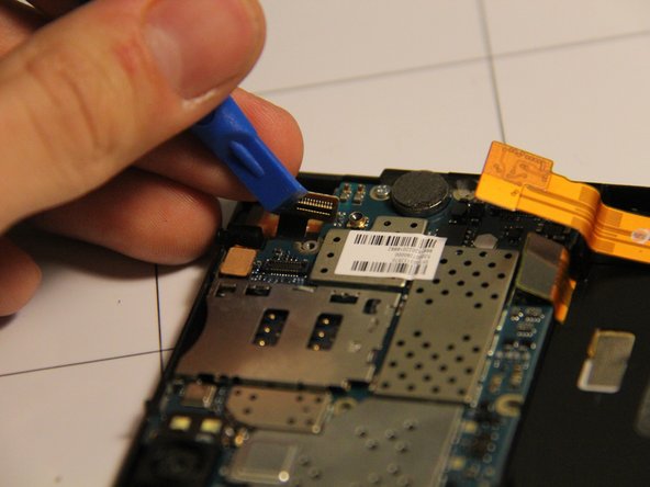

  17. Xiaomi Mi 3 Rear Facing Camera Replacement: crwdns2935265:017crwdnd2935265:01crwdnd2935265:03crwdne2935265:0 Xiaomi Mi 3 Rear Facing Camera Replacement: crwdns2935265:017crwdnd2935265:02crwdnd2935265:03crwdne2935265:0 Xiaomi Mi 3 Rear Facing Camera Replacement: crwdns2935265:017crwdnd2935265:03crwdnd2935265:03crwdne2935265:0

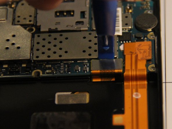

    • Separate a cable ribbon from the top right of the motherboard by gently inserting the pry tool under the rectangular metallic piece and lifting.
  18. Xiaomi Mi 3 Rear Facing Camera Replacement: crwdns2935265:018crwdnd2935265:01crwdnd2935265:03crwdne2935265:0 Xiaomi Mi 3 Rear Facing Camera Replacement: crwdns2935265:018crwdnd2935265:02crwdnd2935265:03crwdne2935265:0 Xiaomi Mi 3 Rear Facing Camera Replacement: crwdns2935265:018crwdnd2935265:03crwdnd2935265:03crwdne2935265:0
    • Separate a cable ribbon from the top right of the motherboard - near the cable from the previous step - by gently inserting the pry tool under the rectangular metallic piece and lifting.

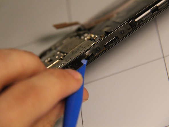

    • Using a pry tool, gently lift the side control buttons assembly away from the case. They should be loosely connected to the motherboard.
  20. Xiaomi Mi 3 Rear Facing Camera Replacement: crwdns2935265:020crwdnd2935265:01crwdnd2935265:02crwdne2935265:0 Xiaomi Mi 3 Rear Facing Camera Replacement: crwdns2935265:020crwdnd2935265:02crwdnd2935265:02crwdne2935265:0
    • Remove these two screws.

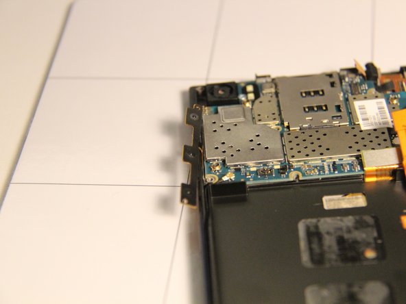

    • Remove the motherboard from the panel carefully. Use the pry tool as a lever from the top of the panel and lift if from that side.
  22. Xiaomi Mi 3 Rear Facing Camera Replacement: crwdns2935265:022crwdnd2935265:01crwdnd2935265:01crwdne2935265:0
    • The motherboard has now been successfully removed.

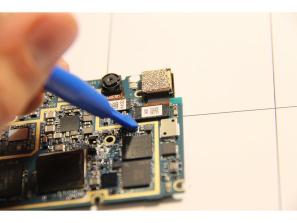

  23. Xiaomi Mi 3 Rear Facing Camera Replacement, Rear Facing Camera: crwdns2935265:023crwdnd2935265:01crwdnd2935265:02crwdne2935265:0 Xiaomi Mi 3 Rear Facing Camera Replacement, Rear Facing Camera: crwdns2935265:023crwdnd2935265:02crwdnd2935265:02crwdne2935265:0
    • After removing the motherboard, use a pry tool to gently remove the camera's ribbon cable from the motherboard.
  24. Xiaomi Mi 3 Rear Facing Camera Replacement: crwdns2935265:024crwdnd2935265:01crwdnd2935265:01crwdne2935265:0
    • The rear facing camera is now removed from the panel successfully.
