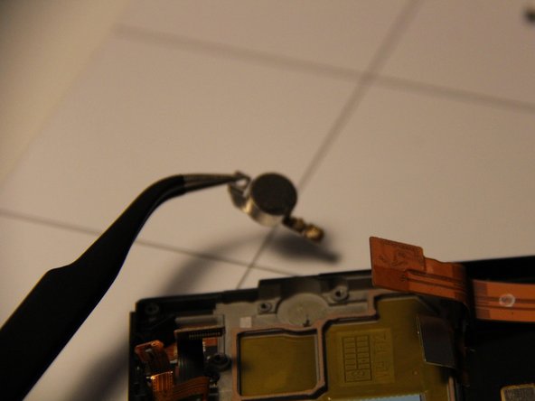

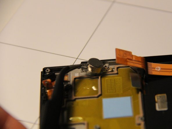

  23. Xiaomi Mi 3 Phone Vibrator Replacement, Phone Vibrator: crwdns2935265:023crwdnd2935265:01crwdnd2935265:03crwdne2935265:0 Xiaomi Mi 3 Phone Vibrator Replacement, Phone Vibrator: crwdns2935265:023crwdnd2935265:02crwdnd2935265:03crwdne2935265:0 Xiaomi Mi 3 Phone Vibrator Replacement, Phone Vibrator: crwdns2935265:023crwdnd2935265:03crwdnd2935265:03crwdne2935265:0
    • With the motherboard removed you can use tweezers to remove the vibrator rather easily.
