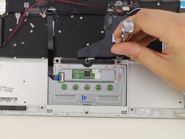

    • Use a PH1 screwdriver to remove the three 2 mm screws.
  16. Xiaomi Air 12 Trackpad Replacement: crwdns2935265:016crwdnd2935265:01crwdnd2935265:03crwdne2935265:0 Xiaomi Air 12 Trackpad Replacement: crwdns2935265:016crwdnd2935265:02crwdnd2935265:03crwdne2935265:0 Xiaomi Air 12 Trackpad Replacement: crwdns2935265:016crwdnd2935265:03crwdnd2935265:03crwdne2935265:0
    • Lift the top end of the trackpad at a small angle and pull the trackpad out.
