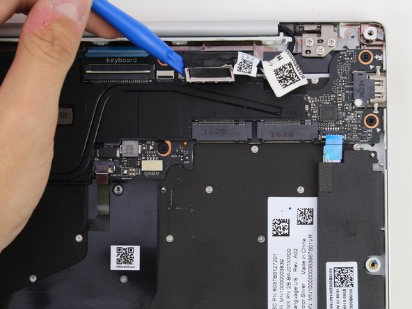

    • Lift the silver connection cover next to the USB ports using the plastic opening tool and your hands.
  13. Xiaomi Air 12 Motherboard Replacement: crwdns2935265:013crwdnd2935265:01crwdnd2935265:03crwdne2935265:0 Xiaomi Air 12 Motherboard Replacement: crwdns2935265:013crwdnd2935265:02crwdnd2935265:03crwdne2935265:0 Xiaomi Air 12 Motherboard Replacement: crwdns2935265:013crwdnd2935265:03crwdnd2935265:03crwdne2935265:0

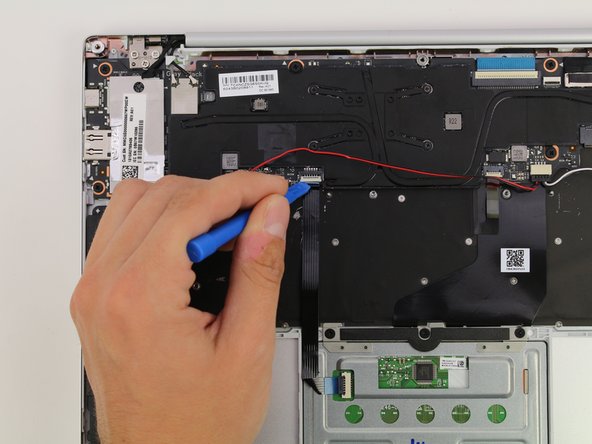

    • Remove the four ribbon cables by lifting the connector up with the plastic opening tool and pulling the ribbon cable out.
  14. Xiaomi Air 12 Motherboard Replacement: crwdns2935265:014crwdnd2935265:01crwdnd2935265:03crwdne2935265:0 Xiaomi Air 12 Motherboard Replacement: crwdns2935265:014crwdnd2935265:02crwdnd2935265:03crwdne2935265:0 Xiaomi Air 12 Motherboard Replacement: crwdns2935265:014crwdnd2935265:03crwdnd2935265:03crwdne2935265:0
    • Disconnect the gray and black wire connectors using the plastic opening tool to lift them up.
  15. Xiaomi Air 12 Motherboard Replacement: crwdns2935265:015crwdnd2935265:01crwdnd2935265:02crwdne2935265:0 Xiaomi Air 12 Motherboard Replacement: crwdns2935265:015crwdnd2935265:02crwdnd2935265:02crwdne2935265:0

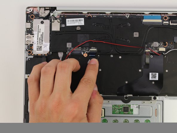

    • Remove the webcam connector by gently pulling the cable out by hand.
  16. Xiaomi Air 12 Motherboard Replacement: crwdns2935265:016crwdnd2935265:01crwdnd2935265:02crwdne2935265:0 Xiaomi Air 12 Motherboard Replacement: crwdns2935265:016crwdnd2935265:02crwdnd2935265:02crwdne2935265:0
    • Lift the video cable on the connector using the plastic opening tool to disconnect it.
