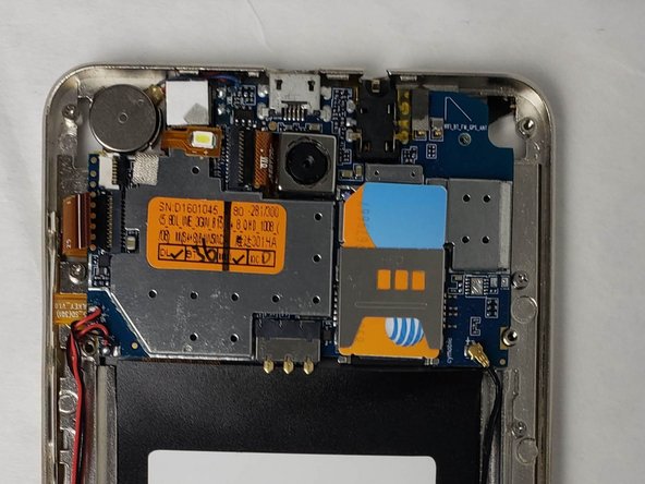

      • Lay the phone on a flat surface so the back is facing upwards.
    2. Xgody D300 Camera Replacement: crwdns2935265:02crwdnd2935265:01crwdnd2935265:01crwdne2935265:0
      • Insert the pry tool into the seam and pry the back cover of the case along the seam until the cover is free of the case.
    3. Xgody D300 Camera Replacement: crwdns2935265:03crwdnd2935265:01crwdnd2935265:02crwdne2935265:0 Xgody D300 Camera Replacement: crwdns2935265:03crwdnd2935265:02crwdnd2935265:02crwdne2935265:0
      • Remove the battery using your hands or the plastic opening tool.
    1. Xgody D300 Camera Replacement, Back-Facing Camera: crwdns2935265:04crwdnd2935265:01crwdnd2935265:02crwdne2935265:0 Xgody D300 Camera Replacement, Back-Facing Camera: crwdns2935265:04crwdnd2935265:02crwdnd2935265:02crwdne2935265:0
      • Using the Phillips #00 screwdriver, remove the screws that hold the protective backing to the smartphone.
      • Three of the screws will not come loose from the protective backing and can be identified by a metal plate that is underneath them.
    2. Xgody D300 Camera Replacement: crwdns2935265:05crwdnd2935265:01crwdnd2935265:02crwdne2935265:0 Xgody D300 Camera Replacement: crwdns2935265:05crwdnd2935265:02crwdnd2935265:02crwdne2935265:0
      • Lift the housing along the edges using the opening tool and tweezers.
      • There will be a sticky pad that holds the housing to the smartphone.
    3. Xgody D300 Camera Replacement: crwdns2935265:06crwdnd2935265:01crwdnd2935265:03crwdne2935265:0 Xgody D300 Camera Replacement: crwdns2935265:06crwdnd2935265:02crwdnd2935265:03crwdne2935265:0 Xgody D300 Camera Replacement: crwdns2935265:06crwdnd2935265:03crwdnd2935265:03crwdne2935265:0
      • Disconnect the camera by grabbing the connector with tweezers and firmly pulling until it pops out.
      • The camera will have a sticky pad on it like the protective backing did and will take a firm tug to come free of the smartphone.
