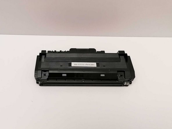

    • Start by pressing the rectangular button on the top-front side of your printer.
    • A door will open, exposing two parts on top of each other, the toner cartridge on top and the toner drum on the bottom.
    • Use the handle of toner cartridge to slide it out towards you.
    • You will be working on this particular part.

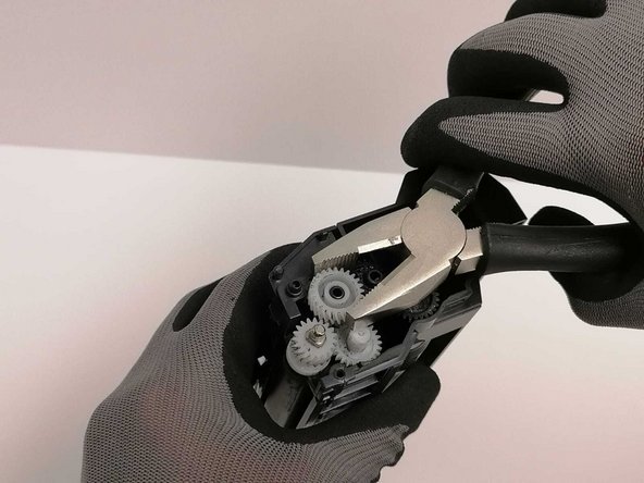

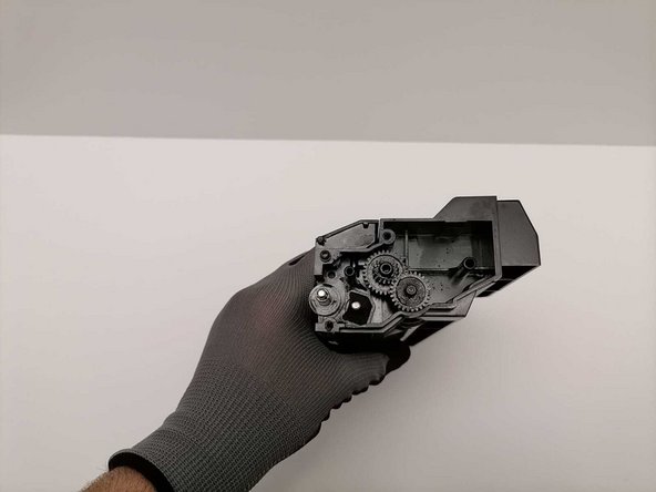

  3. Xerox B201 Toner Roller Replacement: crwdns2935265:03crwdnd2935265:01crwdnd2935265:03crwdne2935265:0 Xerox B201 Toner Roller Replacement: crwdns2935265:03crwdnd2935265:02crwdnd2935265:03crwdne2935265:0 Xerox B201 Toner Roller Replacement: crwdns2935265:03crwdnd2935265:03crwdnd2935265:03crwdne2935265:0
    • On the right side, hold the toner cartridge firmly with one hand, and use your fingers to remove the plastic casing which covers the gearbox.
    • Use a small plier to remove the three white gears from the toner cartridge.
    • Don't remove the two black gears.

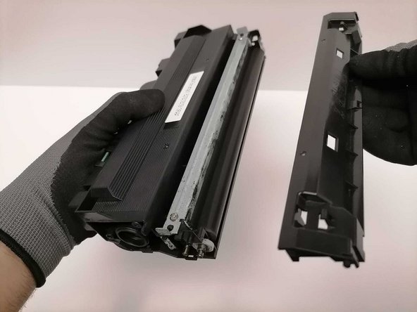

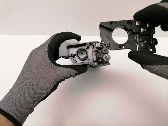

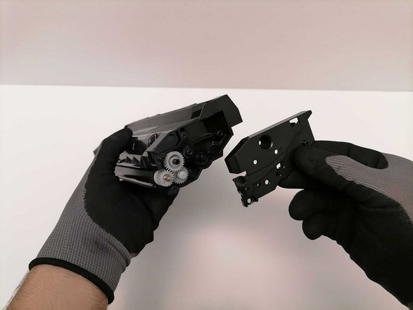

  4. Xerox B201 Toner Roller Replacement: crwdns2935265:04crwdnd2935265:01crwdnd2935265:02crwdne2935265:0 Xerox B201 Toner Roller Replacement: crwdns2935265:04crwdnd2935265:02crwdnd2935265:02crwdne2935265:0
    • Remove the plastic casing on the other side of the toner cartridge.
    • Remove the rectangular plastic case, (that protects the toner roller), in the center of the toner cartridge.

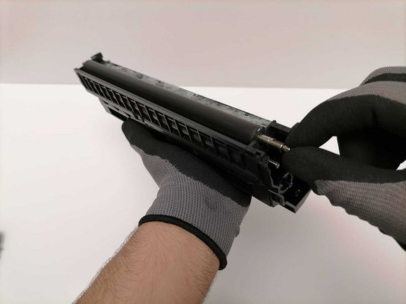

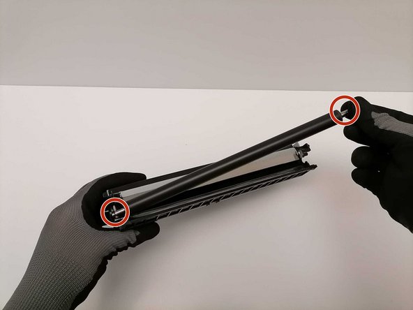

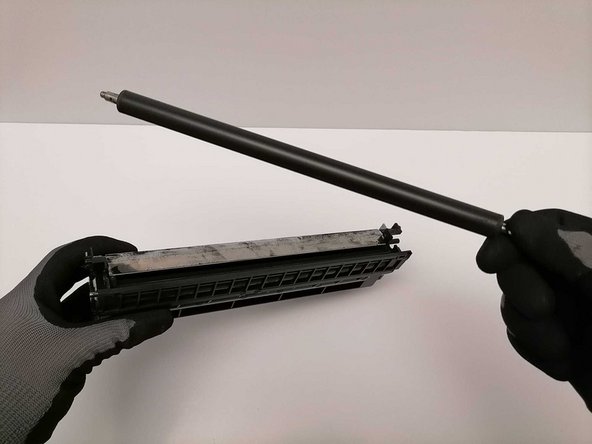

  5. Xerox B201 Toner Roller Replacement: crwdns2935265:05crwdnd2935265:01crwdnd2935265:03crwdne2935265:0 Xerox B201 Toner Roller Replacement: crwdns2935265:05crwdnd2935265:02crwdnd2935265:03crwdne2935265:0 Xerox B201 Toner Roller Replacement: crwdns2935265:05crwdnd2935265:03crwdnd2935265:03crwdne2935265:0
    • Rotate the toner cartridge so that the metal line is facing you.
    • The black cylinder is the toner roller.
    • Remove the two white circular spacers on both sides of the toner cartridge.
    • Use pliers to remove them if they are difficult to remove by hand.
    • Hold the end of the right side of the toner roller by the metal rod.
    • Hold the toner cartridge firmly with your other hand and remove the toner roller.

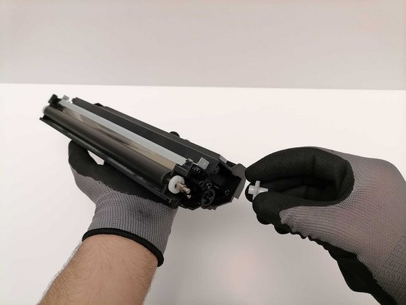

  7. Xerox B201 Toner Roller Replacement: crwdns2935265:07crwdnd2935265:01crwdnd2935265:02crwdne2935265:0 Xerox B201 Toner Roller Replacement: crwdns2935265:07crwdnd2935265:02crwdnd2935265:02crwdne2935265:0
    • Place the two white circular spacers back on both sides of the toner roller.
    • Place the three white gears back on the right side of the toner roller.
    • Make sure the three white gears are in place, and that they all rotate synchronously.
