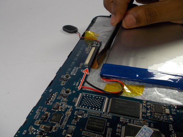

  4. Xelio P900A-BK Screen Replacement: crwdns2935265:04crwdnd2935265:01crwdnd2935265:02crwdne2935265:0 Xelio P900A-BK Screen Replacement: crwdns2935265:04crwdnd2935265:02crwdnd2935265:02crwdne2935265:0

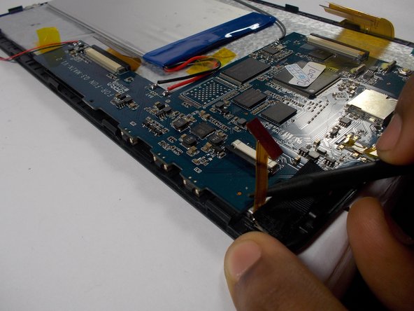

    • Next, disconnect the front facing camera ribbon (shown). The ribbon is held to the motherboard by a small bar.
    • Using the spudger to pry open the bar, pull the ribbon out to disconnect it.
  5. Xelio P900A-BK Screen Replacement: crwdns2935265:05crwdnd2935265:01crwdnd2935265:02crwdne2935265:0 Xelio P900A-BK Screen Replacement: crwdns2935265:05crwdnd2935265:02crwdnd2935265:02crwdne2935265:0

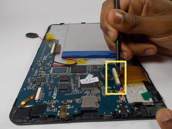

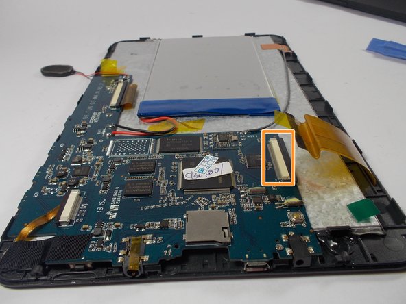

    • Next, work on disconnecting the ribbon for the touch screen.
    • The touch screen ribbon is larger than the camera ribbon and is located on the left side of motherboard.
    • Using the spudger, gently pry the ribbon out from under the bar. Pull the ribbon and disconnect it from the motherboard.

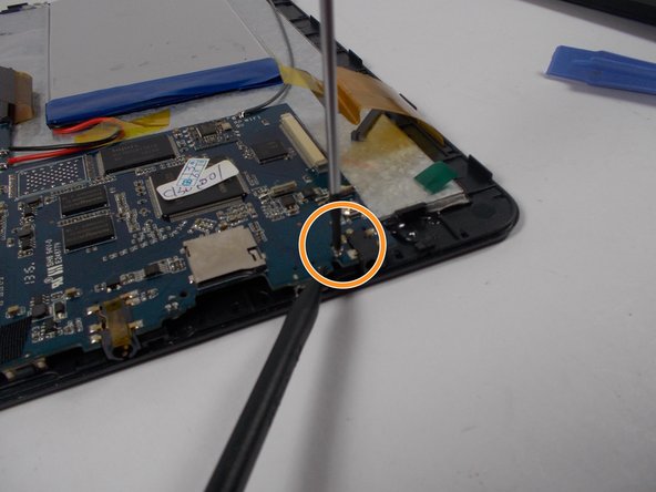

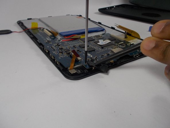

    • Remove the two motherboard screws.
    • To remove the first screw, expose the black strip. Then using a Philips head screwdriver, remove the first screw.
    • Locate the second screw by looking to the bottom right of the motherboard. Remove the second screw with the Philips head screwdriver.

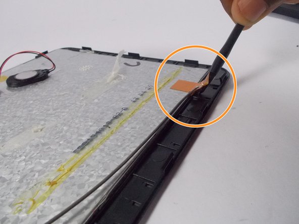

    • Locate the last connection to the LCD in the top right section of the tablet.
    • The last connection is a ribbon connected to green wire, which is held down by tape.
    • Disconnect the ribbon by removing the tape connecting it to the plastic frame of the tablet.
