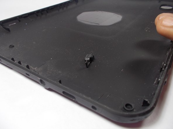

    • Using a Philips screwdriver, remove the two 2.44 mm screws from the back plate of the tablet.
  2. Xelio P900A-BK Power Button Replacement: crwdns2935265:02crwdnd2935265:01crwdnd2935265:03crwdne2935265:0 Xelio P900A-BK Power Button Replacement: crwdns2935265:02crwdnd2935265:02crwdnd2935265:03crwdne2935265:0 Xelio P900A-BK Power Button Replacement: crwdns2935265:02crwdnd2935265:03crwdnd2935265:03crwdne2935265:0
    • Using a plastic opening tool, pry the back cover from the screen.
    • Gently separate the two sides.
  3. Xelio P900A-BK Power Button Replacement: crwdns2935265:03crwdnd2935265:01crwdnd2935265:02crwdne2935265:0 Xelio P900A-BK Power Button Replacement: crwdns2935265:03crwdnd2935265:02crwdnd2935265:02crwdne2935265:0
    • Push on the old power button to remove it and install the new power button.
    • There are no wires connecting the power button to the device. It should come away easily.
