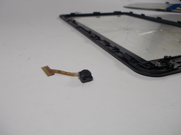

  4. Xelio P900A-BK Front Facing Camera Replacement: crwdns2935265:04crwdnd2935265:01crwdnd2935265:01crwdne2935265:0
    • Remove the tape covering the front facing camera entirely to expose one of the motherboard screws.

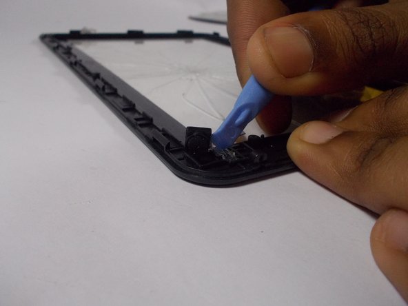

  5. Xelio P900A-BK Front Facing Camera Replacement: crwdns2935265:05crwdnd2935265:01crwdnd2935265:03crwdne2935265:0 Xelio P900A-BK Front Facing Camera Replacement: crwdns2935265:05crwdnd2935265:02crwdnd2935265:03crwdne2935265:0 Xelio P900A-BK Front Facing Camera Replacement: crwdns2935265:05crwdnd2935265:03crwdnd2935265:03crwdne2935265:0
    • Use the smaller plastic opening tool to remove the camera from its socket.
