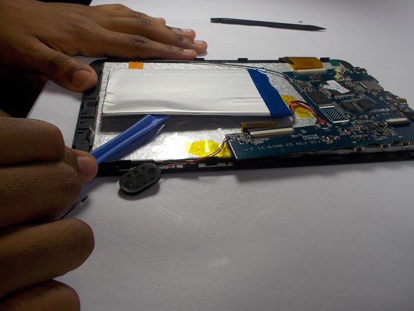

    • Using a #00 Phillips head screwdriver, remove the two 5.4mm bottom screws.
  2. Xelio P900A-BK Battery Replacement: crwdns2935265:02crwdnd2935265:01crwdnd2935265:02crwdne2935265:0 Xelio P900A-BK Battery Replacement: crwdns2935265:02crwdnd2935265:02crwdnd2935265:02crwdne2935265:0
    • Insert a plastic opening tool between the screen and the rear case and gently work your way around the tablet.
  3. Xelio P900A-BK Battery Replacement: crwdns2935265:03crwdnd2935265:01crwdnd2935265:01crwdne2935265:0
    • Using the plastic opening tool or your fingers, gently pry the pieces of the tablet apart. You will hear the plastic latches pop free.
  4. Xelio P900A-BK Battery Replacement: crwdns2935265:04crwdnd2935265:01crwdnd2935265:03crwdne2935265:0 Xelio P900A-BK Battery Replacement: crwdns2935265:04crwdnd2935265:02crwdnd2935265:03crwdne2935265:0 Xelio P900A-BK Battery Replacement: crwdns2935265:04crwdnd2935265:03crwdnd2935265:03crwdne2935265:0

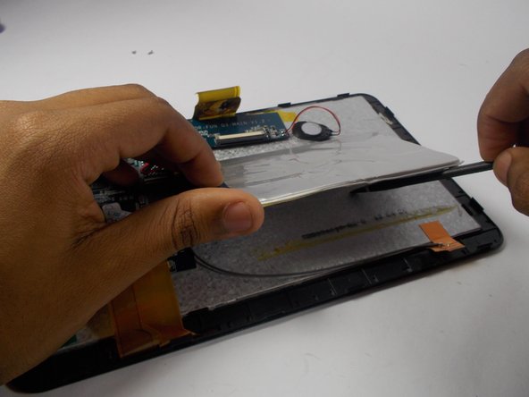

  5. Xelio P900A-BK Battery Replacement: crwdns2935265:05crwdnd2935265:01crwdnd2935265:02crwdne2935265:0 Xelio P900A-BK Battery Replacement: crwdns2935265:05crwdnd2935265:02crwdnd2935265:02crwdne2935265:0
    • Carefully insert the flat end of a nylon spudger under the battery, and pry the battery up and away from the tablet casing.
    • A small amount of heat may be required to safely remove the battery from the adhesive underneath. Use an iOpener or heat gun to soften the adhesive.
    • Do not bend or puncture the battery.
    • Place the new battery in the same place as the old one, making sure it is oriented the same way as the old one was.
