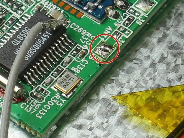

  3. Xelio P1001A-BK Wi-Fi Antenna Replacement, Wi-Fi Antenna: crwdns2935265:03crwdnd2935265:01crwdnd2935265:02crwdne2935265:0 Xelio P1001A-BK Wi-Fi Antenna Replacement, Wi-Fi Antenna: crwdns2935265:03crwdnd2935265:02crwdnd2935265:02crwdne2935265:0
    • Desolder the connection on the motherboard.
    • Use a soldering vacuum to remove any excess solder.
  4. Xelio P1001A-BK Wi-Fi Antenna Replacement: crwdns2935265:04crwdnd2935265:01crwdnd2935265:01crwdne2935265:0
    • Use wire strippers to strip off at least 2 mm of wire insulation from each wire.
  5. Xelio P1001A-BK Wi-Fi Antenna Replacement: crwdns2935265:05crwdnd2935265:01crwdnd2935265:01crwdne2935265:0
    • Solder the outer wire braid shield to the ground point.
  6. Xelio P1001A-BK Wi-Fi Antenna Replacement: crwdns2935265:06crwdnd2935265:01crwdnd2935265:01crwdne2935265:0
    • Solder the center conductor to the antenna point.
