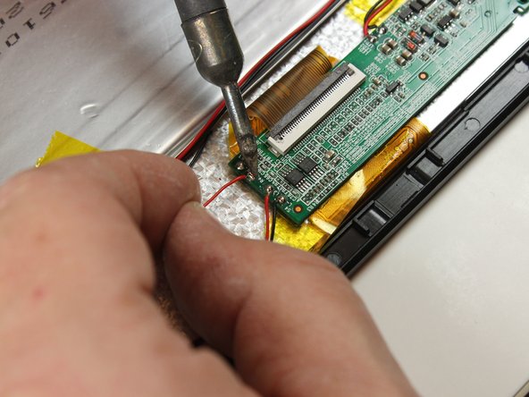

    • Desolder the two speaker wires with the soldering iron by melting the solder so the wires can be removed.
    • Remove the wires from the soldering points once they have loosened.
    • Use a soldering vacuum to remove the excess solder from the board.
  4. Xelio P1001A-BK Speakers Replacement: crwdns2935265:04crwdnd2935265:01crwdnd2935265:01crwdne2935265:0
    • Inspect your wires. You should see 2 mm of exposed wire before you move to the next step.
    • If necessary, use your wire-stripping tool to strip 2 mm of insulation from each wire.
  5. Xelio P1001A-BK Speakers Replacement: crwdns2935265:05crwdnd2935265:01crwdnd2935265:01crwdne2935265:0
    • Place the exposed wire in the soldering point.
    • Apply the soldering iron to the point just until the wire is secured.
    • Repeat these two steps for the second wire.
