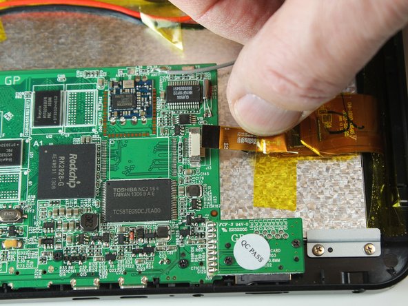

    • Remove the motherboard to screen ribbon cable
    • Pry the ribbon cable retaining tab loose with plastic opening tool.
    • Slide the ribbon cable out from the connector.

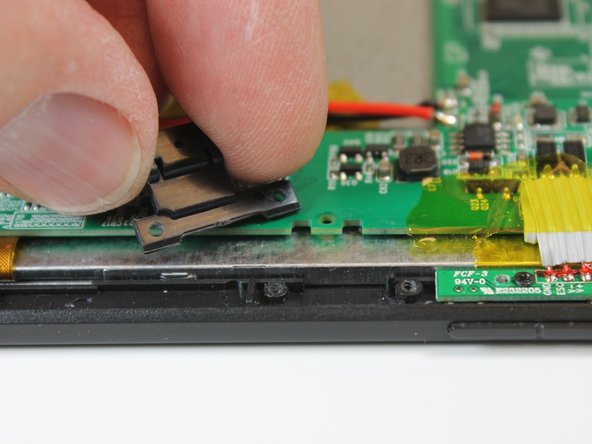

    • Remove the two motherboard retaining clip screws with a No. 0 Philips head screwdriver
    • Remove the retaining clip from the board.
  7. Xelio P1001A-BK DC Power Socket Replacement: crwdns2935265:07crwdnd2935265:01crwdnd2935265:01crwdne2935265:0
    • With the No. 0 Phillips head screwdriver, remove the two screw that hold the function and volume control switch assembly to the tablet.

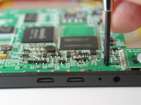

    • Remove the three screws that secure the motherboard to the tablet frame
  10. Xelio P1001A-BK DC Power Socket Replacement: crwdns2935265:010crwdnd2935265:01crwdnd2935265:02crwdne2935265:0 Xelio P1001A-BK DC Power Socket Replacement: crwdns2935265:010crwdnd2935265:02crwdnd2935265:02crwdne2935265:0

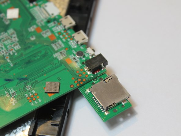

    • Gently lift the motherboard free from the tablet frame and turn it over to expose the opposite side. This will expose the power socket solder pins.
    • Be cautious when turning the board over as another ribbon cable, the speaker wires, battery wires, and Wi-Fi antenna wire as still connected to the motherboard.
  11. Xelio P1001A-BK DC Power Socket Replacement: crwdns2935265:011crwdnd2935265:01crwdnd2935265:01crwdne2935265:0
    • De-solder each of the solder points.
  12. Xelio P1001A-BK DC Power Socket Replacement: crwdns2935265:012crwdnd2935265:01crwdnd2935265:01crwdne2935265:0
    • Remove the damaged power socket.
    • Use a needle nose pliers or pair of tweezers to hold the power socket as it is a small part and may be difficult to hold.
    • Be careful to avoid touching the solder pins as they may still be hot
