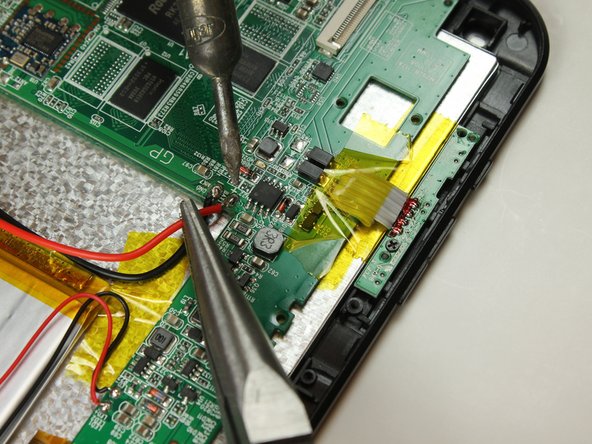

  3. Xelio P1001A-BK Battery Pack Replacement, Battery Pack: crwdns2935265:03crwdnd2935265:01crwdnd2935265:02crwdne2935265:0 Xelio P1001A-BK Battery Pack Replacement, Battery Pack: crwdns2935265:03crwdnd2935265:02crwdnd2935265:02crwdne2935265:0

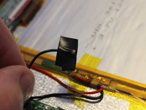

    • De-solder the two wires that connect the battery pack to the motherboard using a needle-nose plier and a soldering iron.
    • Wrap the exposed end of the black negative wire with electrical tape.

    • Solder the red battery wire to the point labeled BATT +, and the black battery wire to the point BATT -.
    • If the wire ends are not exposed, strip 3mm of insulation from the end using a wire stripper. Start with the black negative wire and wrap the exposed ends with electrical tape.
