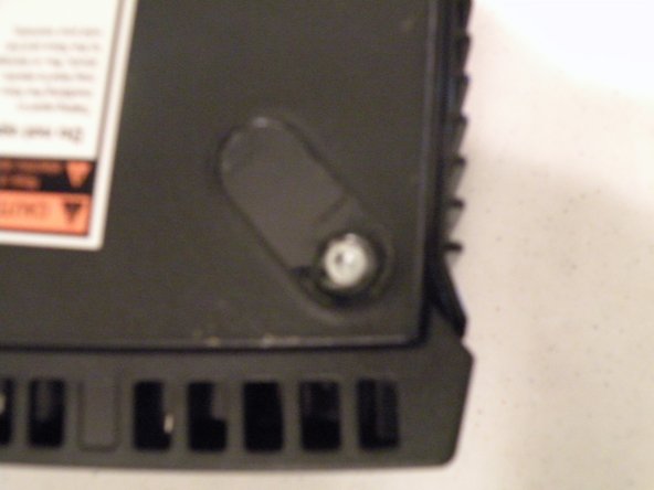

  3. Xbox Teardown: crwdns2935265:03crwdnd2935265:01crwdnd2935265:03crwdne2935265:0 Xbox Teardown: crwdns2935265:03crwdnd2935265:02crwdnd2935265:03crwdne2935265:0 Xbox Teardown: crwdns2935265:03crwdnd2935265:03crwdnd2935265:03crwdne2935265:0

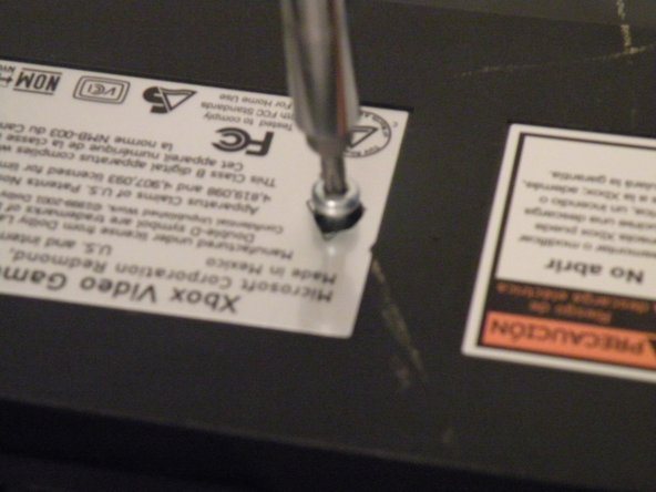

    • Doing this should reveal 4 T10 Torx Screws, But, there are 2 more hidden by stickers.
    • The hidden screws are shown in yellow.
    • Removing the 2 screws hidden by stickers will void your warranty, even though I'm sure that your warranty has already expired.

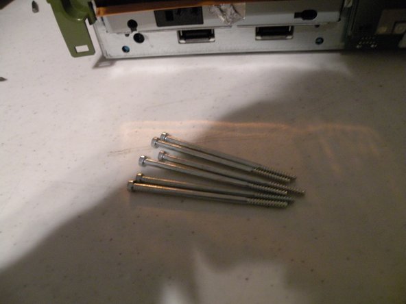

  4. Xbox Teardown: crwdns2935265:04crwdnd2935265:01crwdnd2935265:02crwdne2935265:0 Xbox Teardown: crwdns2935265:04crwdnd2935265:02crwdnd2935265:02crwdne2935265:0
    • Remove the 6 T10 Screws.

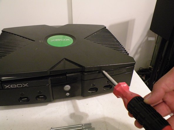

    • To remove the top half of the console, flip it upright and use a flathead screwdriver to separate the two halves.

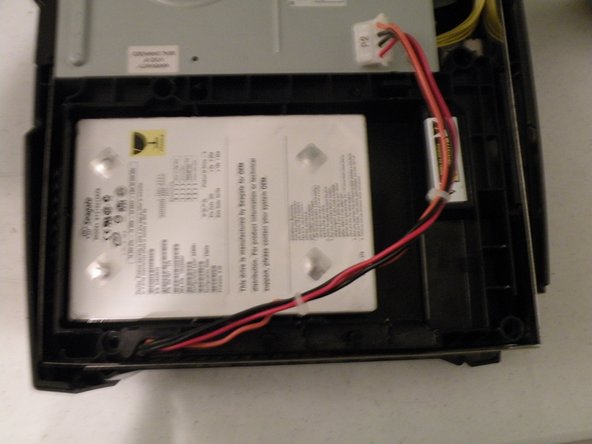

  6. Xbox Teardown: crwdns2935265:06crwdnd2935265:01crwdnd2935265:02crwdne2935265:0 Xbox Teardown: crwdns2935265:06crwdnd2935265:02crwdnd2935265:02crwdne2935265:0
    • Simply lift the top half off.
    • This reveals the drives.

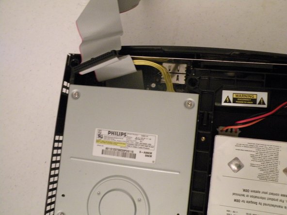

    • From Left To Right: The DVD-ROM Drive, And A Seagate 8GB Parallel ATA Drive

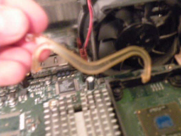

    • Start by removing the ATA Cable from both drives. There might be a piece of double sided tape holding the ribbon cable in place.

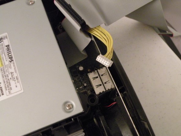

    • Next, remove the power cables from the drives.
    • The hard drive uses a standard molex connector for power, but the DVD-ROM drive uses a proprietary xbox connector similar to that of the xbox 360.
  9. Xbox Teardown: crwdns2935265:09crwdnd2935265:01crwdnd2935265:02crwdne2935265:0 Xbox Teardown: crwdns2935265:09crwdnd2935265:02crwdnd2935265:02crwdne2935265:0
    • Remove the DVD-ROM power cable.

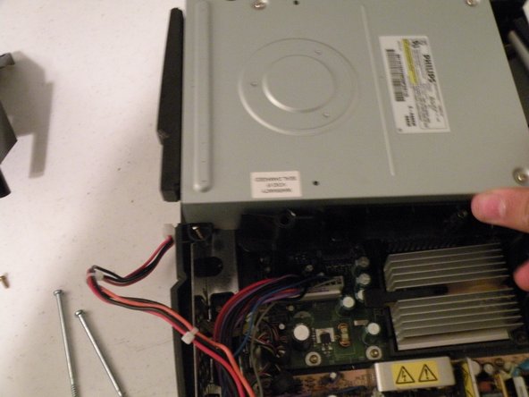

  10. Xbox Teardown: crwdns2935265:010crwdnd2935265:01crwdnd2935265:01crwdne2935265:0
    • Before we can continue, there are 3 T8 Torx screws hidden here that we need to remove.

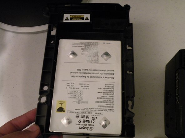

  11. Xbox Teardown: crwdns2935265:011crwdnd2935265:01crwdnd2935265:02crwdne2935265:0 Xbox Teardown: crwdns2935265:011crwdnd2935265:02crwdnd2935265:02crwdne2935265:0
    • Lift the hard drive and the plastic attatched to it out, you will need to route the power cable so you can get it out.

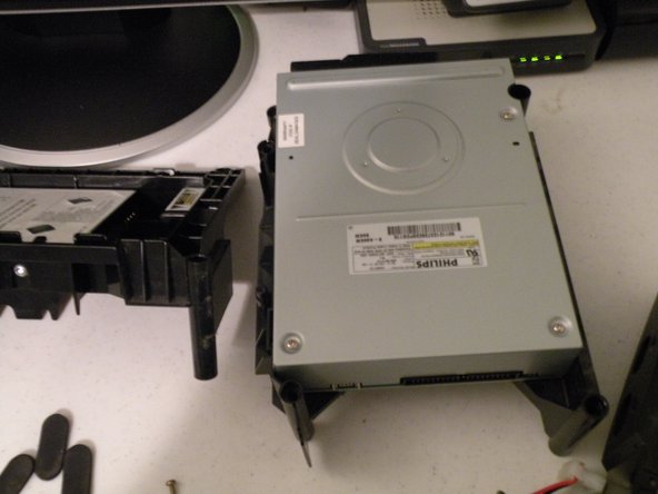

  12. Xbox Teardown: crwdns2935265:012crwdnd2935265:01crwdnd2935265:03crwdne2935265:0 Xbox Teardown: crwdns2935265:012crwdnd2935265:02crwdnd2935265:03crwdne2935265:0 Xbox Teardown: crwdns2935265:012crwdnd2935265:03crwdnd2935265:03crwdne2935265:0
    • Removing the DVD-ROM drive.
    • Lift the DVD-ROM drive and the plastic attached to it out. This reveals the logic board.

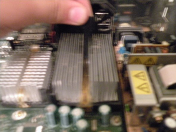

    • Removing the heatsinks.
    • The big one to the right, is the CPU, the smaller one to the left is for the GPU.
    • Lift the black tab up on the cpu heatsink. This will release the tension on the chip.
    • Next, use a flathead screwdriver to remove the clip. Then lift the CPU heatsink out (this may take some force).

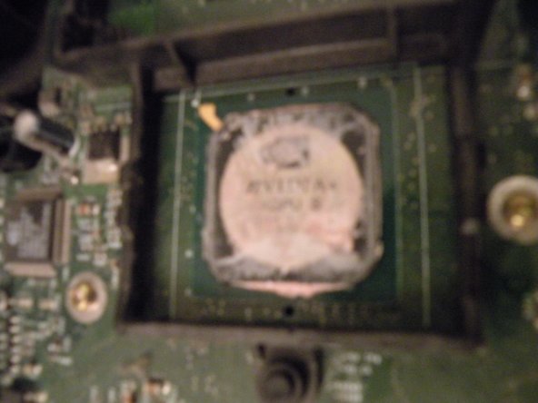

    • The GPU
    • Push on the tab on the GPU heatsink. While doing this, use a flathead screwdriver to push on the tab so when released, it clears the latch
    • Be careful, if you break any one of these tabs, then, your heatsinks will not be usable, and your console will fry, if you try to run it.
    • Removing the GPU heatsink, reveals an NVIDIA NV2A.
