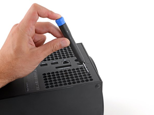

    • Before you begin, completely power down and unplug all cables from your console.
    • A locking tab on the bottom of the shell (under the base) holds the base in place.
    • You can access the tab through the vent holes on the back of your Xbox, but you may need a flashlight. Alternatively, you can remove the back panel for easier access.
    • Stick a long, skinny flathead screwdriver through one of the vent holes on the back of your Xbox, near the locking tab.
    • Insert the screwdriver between the locking tab and the base. This might take a few tries—use a flashlight if you're having trouble.
    • Use the screwdriver to pry the tab inward (away from the base) into its open and unlocked position.
    • Keep the tab held open for the next step.
  2. Xbox Series X 2TB Galaxy Black Base Replacement, Twist and remove the base: crwdns2935265:02crwdnd2935265:01crwdnd2935265:03crwdne2935265:0 Xbox Series X 2TB Galaxy Black Base Replacement, Twist and remove the base: crwdns2935265:02crwdnd2935265:02crwdnd2935265:03crwdne2935265:0 Xbox Series X 2TB Galaxy Black Base Replacement, Twist and remove the base: crwdns2935265:02crwdnd2935265:03crwdnd2935265:03crwdne2935265:0
    • With the locking tab held open, grip the base and rotate it counterclockwise to unlock it from the shell.
    • Remove the base.
    • During reassembly, put the base tabs into their holes on the shell and twist clockwise until the base snaps into the interior locking tab.
    • When locked in place, the Hello from Seattle line will be parallel with the device's sides.
