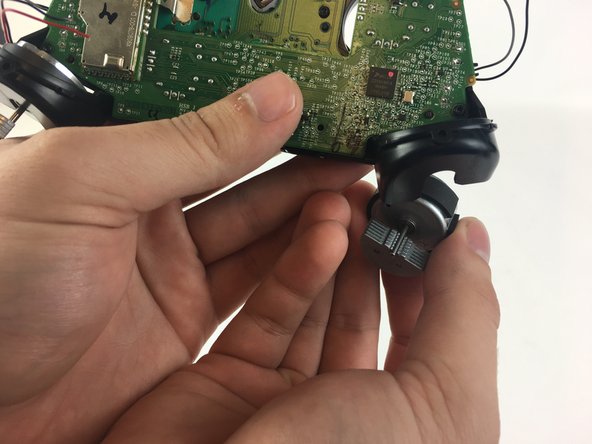

  6. Xbox One Wireless Controller 1697 Rumble Motor Replacement, Rumble Motor: crwdns2935265:06crwdnd2935265:01crwdnd2935265:02crwdne2935265:0 Xbox One Wireless Controller 1697 Rumble Motor Replacement, Rumble Motor: crwdns2935265:06crwdnd2935265:02crwdnd2935265:02crwdne2935265:0
    • De-solder the soldered joints while holding the red and black wires down on the top motherboard.
    • Use the How to Solder and Desolder Connections guide on iFixit to correctly (de)solder the components in your device.
    • Use caution while using the soldering iron so you don't damage other components or hurt yourself.
  7. Xbox One Wireless Controller 1697 Rumble Motor Replacement: crwdns2935265:07crwdnd2935265:01crwdnd2935265:01crwdne2935265:0
    • Remove the rumble motors.
