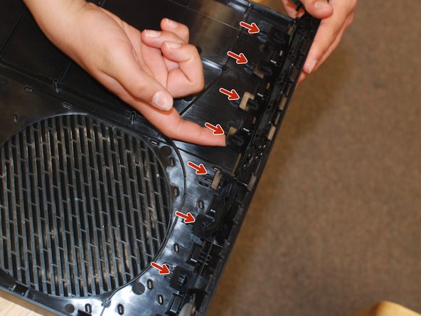

    • First things we are going to take the front off the top plastic panel.
    • To disconnect this piece you must simultaneously lift all the following clips then tilt the piece outward and away and it should come free; this ones tricky and may take a helping had.
  13. Xbox One Wifi Card Replacement, Continued...: crwdns2935265:013crwdnd2935265:01crwdnd2935265:01crwdne2935265:0
    • Now take the top panel and clip it back into place it should all snap down.
    • When reassembling the front make sure you hook the blue ribbon back into place first then slide the bottom in first on the panel; after that push the clips until they snap and it is slipped in tight.

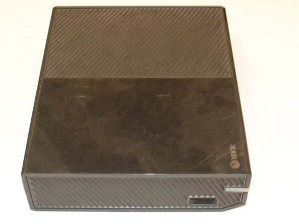

    • Now take the brace for the sync button and slide it back in on the track once you've done that your sync button should click repeatedly, if not try it again.
    • Just about there, for your last step shown in picture two, take the side panel and clip into place until all clips are snug and snapped in; once you've completed that you have finished replacing your wifi card and resembling your console.
