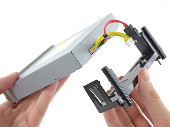

    1. Xbox One Optical Drive Replacement, Optical Drive: crwdns2935265:020crwdnd2935265:01crwdnd2935265:02crwdne2935265:0 Xbox One Optical Drive Replacement, Optical Drive: crwdns2935265:020crwdnd2935265:02crwdnd2935265:02crwdne2935265:0
      • Disconnect the optical drive power and SATA data cables from the motherboard.
    2. Xbox One Optical Drive Replacement: crwdns2935265:021crwdnd2935265:01crwdnd2935265:01crwdne2935265:0
      • Remove the optical drive assembly from the Xbox.
    3. Xbox One Optical Drive Replacement: crwdns2935265:022crwdnd2935265:01crwdnd2935265:03crwdne2935265:0 Xbox One Optical Drive Replacement: crwdns2935265:022crwdnd2935265:02crwdnd2935265:03crwdne2935265:0 Xbox One Optical Drive Replacement: crwdns2935265:022crwdnd2935265:03crwdnd2935265:03crwdne2935265:0
      • The optical drive tray is held onto the optical drive by two plastic clips.
      • Push the clips outward and then slide the tray off the drive.

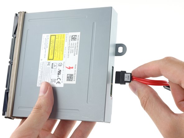

    4. Xbox One Optical Drive Replacement: crwdns2935265:023crwdnd2935265:01crwdnd2935265:02crwdne2935265:0 Xbox One Optical Drive Replacement: crwdns2935265:023crwdnd2935265:02crwdnd2935265:02crwdne2935265:0
      • Remove the optical drive power and SATA data cables.
