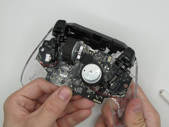

    • Remove both screws on the back of the motherboard under the triggers using a Phillips #1 screwdriver.
  4. Xbox One Afterglow Prismatic Wired Controller Button and Trigger Replacement: crwdns2935265:04crwdnd2935265:01crwdnd2935265:03crwdne2935265:0 Xbox One Afterglow Prismatic Wired Controller Button and Trigger Replacement: crwdns2935265:04crwdnd2935265:02crwdnd2935265:03crwdne2935265:0 Xbox One Afterglow Prismatic Wired Controller Button and Trigger Replacement: crwdns2935265:04crwdnd2935265:03crwdnd2935265:03crwdne2935265:0
    • Place your left hand at the base of the motherboard and your right hand on the frame.
    • Lift the motherboard up from the pegs that hold it in place.
    • The motherboard will still be connected to the controller once off the pegs.
    • Do not try to force the motherboard out after getting it off the pegs.
    • Pull down gently to remove the motherboard.
  5. Xbox One Afterglow Prismatic Wired Controller Button and Trigger Replacement: crwdns2935265:05crwdnd2935265:01crwdnd2935265:02crwdne2935265:0 Xbox One Afterglow Prismatic Wired Controller Button and Trigger Replacement: crwdns2935265:05crwdnd2935265:02crwdnd2935265:02crwdne2935265:0

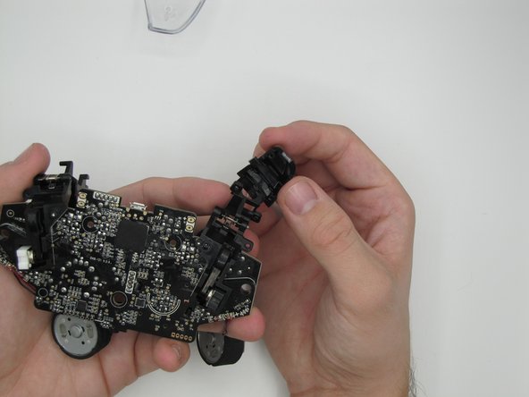

    • Under each trigger is a small guard rail that needs to be pushed in order to get to the screws for the trigger.
    • Push the rail towards the motherboard to free the triggers to get to the screws.
  6. Xbox One Afterglow Prismatic Wired Controller Button and Trigger Replacement: crwdns2935265:06crwdnd2935265:01crwdnd2935265:01crwdne2935265:0
    • Remove the two screws from each of the triggers (four total) using a Phillips #1 screwdriver.
    • The triggers will fall out when unscrewed.
  7. Xbox One Afterglow Prismatic Wired Controller Button and Trigger Replacement: crwdns2935265:07crwdnd2935265:01crwdnd2935265:03crwdne2935265:0 Xbox One Afterglow Prismatic Wired Controller Button and Trigger Replacement: crwdns2935265:07crwdnd2935265:02crwdnd2935265:03crwdne2935265:0 Xbox One Afterglow Prismatic Wired Controller Button and Trigger Replacement: crwdns2935265:07crwdnd2935265:03crwdnd2935265:03crwdne2935265:0
    • Replace each of the triggers by screwing them back together.
    • Push the rail back onto the trigger peg.
    • The motherboard is done until reassembly.

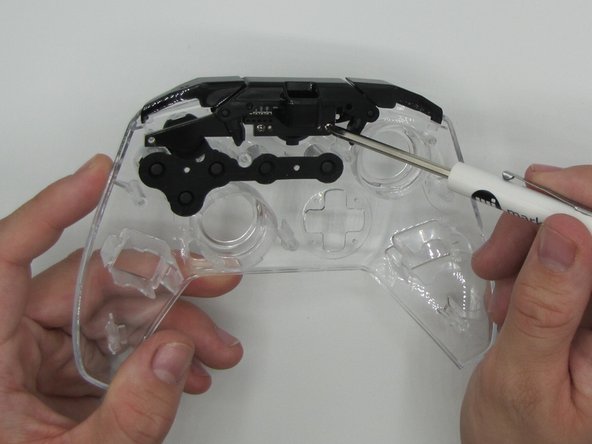

    • Remove the two screws from the top bumper board using a Phillips #1 screwdriver.

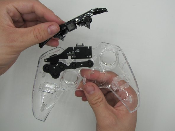

  9. Xbox One Afterglow Prismatic Wired Controller Button and Trigger Replacement: crwdns2935265:09crwdnd2935265:01crwdnd2935265:02crwdne2935265:0 Xbox One Afterglow Prismatic Wired Controller Button and Trigger Replacement: crwdns2935265:09crwdnd2935265:02crwdnd2935265:02crwdne2935265:0
    • Pull up on the bumper board to remove it.

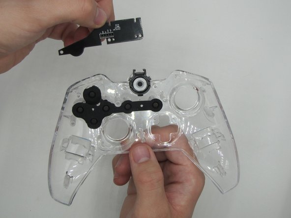

  10. Xbox One Afterglow Prismatic Wired Controller Button and Trigger Replacement: crwdns2935265:010crwdnd2935265:01crwdnd2935265:02crwdne2935265:0 Xbox One Afterglow Prismatic Wired Controller Button and Trigger Replacement: crwdns2935265:010crwdnd2935265:02crwdnd2935265:02crwdne2935265:0
    • Pick up the circuit board to remove it from the base.
    • The circuit board is loose and might fall out in Step 9.

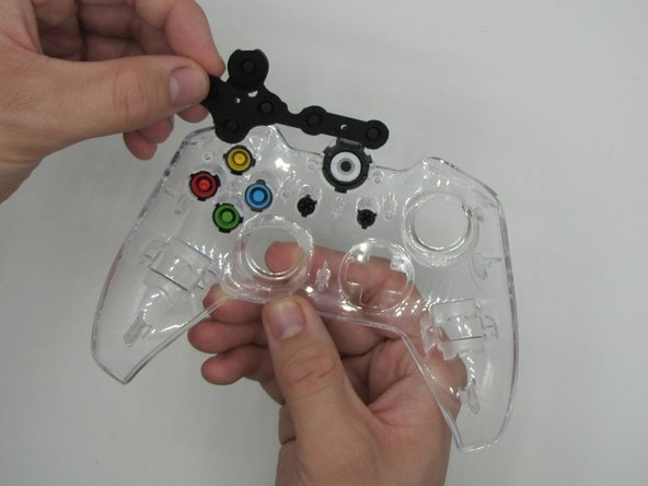

  11. Xbox One Afterglow Prismatic Wired Controller Button and Trigger Replacement: crwdns2935265:011crwdnd2935265:01crwdnd2935265:02crwdne2935265:0 Xbox One Afterglow Prismatic Wired Controller Button and Trigger Replacement: crwdns2935265:011crwdnd2935265:02crwdnd2935265:02crwdne2935265:0
    • Remove the rubber button cover.
  12. Xbox One Afterglow Prismatic Wired Controller Button and Trigger Replacement: crwdns2935265:012crwdnd2935265:01crwdnd2935265:02crwdne2935265:0 Xbox One Afterglow Prismatic Wired Controller Button and Trigger Replacement: crwdns2935265:012crwdnd2935265:02crwdnd2935265:02crwdne2935265:0

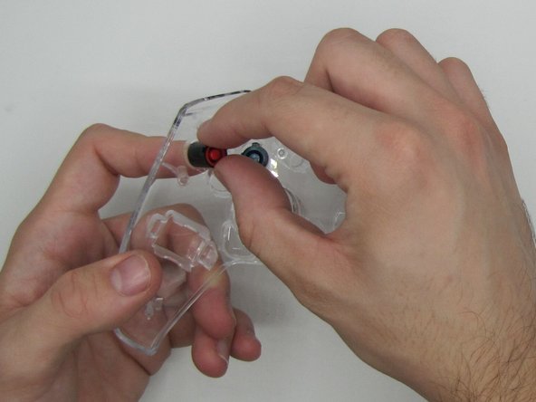

    • Remove the inner buttons.
  13. Xbox One Afterglow Prismatic Wired Controller Button and Trigger Replacement: crwdns2935265:013crwdnd2935265:01crwdnd2935265:02crwdne2935265:0 Xbox One Afterglow Prismatic Wired Controller Button and Trigger Replacement: crwdns2935265:013crwdnd2935265:02crwdnd2935265:02crwdne2935265:0
    • Replace each of the buttons.
    • Each of the buttons have pegs that will help you line them up in the correct location and orientation.
