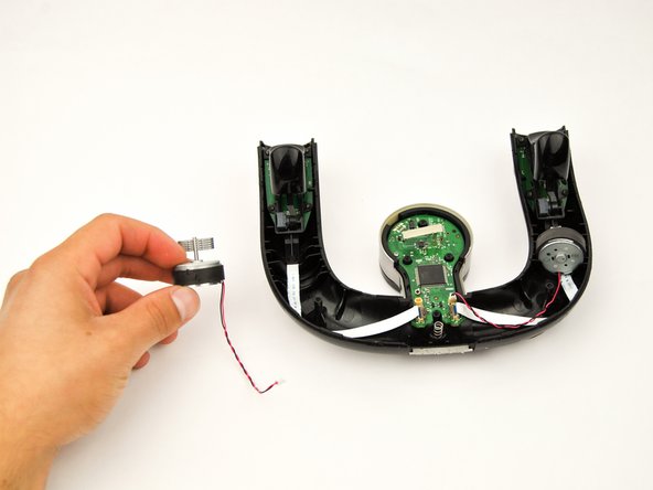

  11. Xbox 360 Wireless Speed Wheel Xbox Button Replacement, Xbox Button: crwdns2935265:011crwdnd2935265:01crwdnd2935265:02crwdne2935265:0 Xbox 360 Wireless Speed Wheel Xbox Button Replacement, Xbox Button: crwdns2935265:011crwdnd2935265:02crwdnd2935265:02crwdne2935265:0
    • Use a T6 Torx screwdriver to remove the 2.3 mm screw.
    • Carefully lift and remove the circuit board

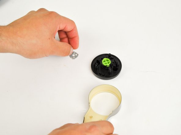

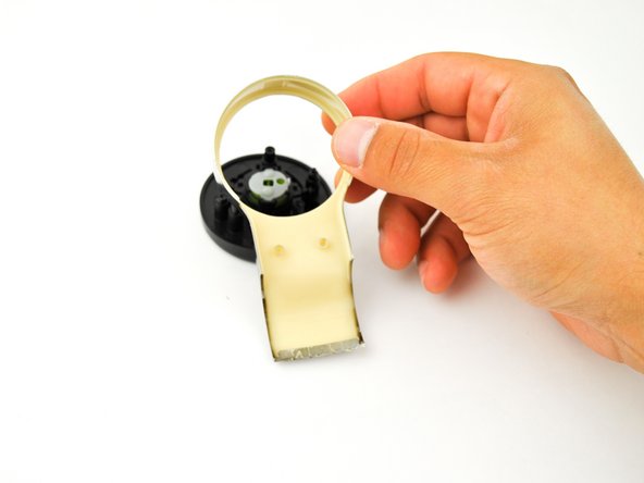

  12. Xbox 360 Wireless Speed Wheel Xbox Button Replacement: crwdns2935265:012crwdnd2935265:01crwdnd2935265:03crwdne2935265:0 Xbox 360 Wireless Speed Wheel Xbox Button Replacement: crwdns2935265:012crwdnd2935265:02crwdnd2935265:03crwdne2935265:0 Xbox 360 Wireless Speed Wheel Xbox Button Replacement: crwdns2935265:012crwdnd2935265:03crwdnd2935265:03crwdne2935265:0
    • Lift the controller to separate the black part from the silver boundary plate.
    • Lift the silver boundary plate to remove it from the round black, middle piece.
    • Remove the gray silicone cover to expose the backside of the bright green, round "X" button.
  13. Xbox 360 Wireless Speed Wheel Xbox Button Replacement: crwdns2935265:013crwdnd2935265:01crwdnd2935265:01crwdne2935265:0
    • Pull the "X" button out of the clear plastic casing.
