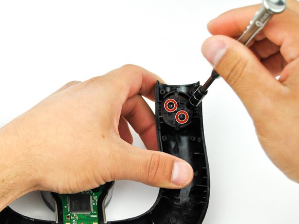

  11. Xbox 360 Wireless Speed Wheel D-pad Replacement, D-pad: crwdns2935265:011crwdnd2935265:01crwdnd2935265:03crwdne2935265:0 Xbox 360 Wireless Speed Wheel D-pad Replacement, D-pad: crwdns2935265:011crwdnd2935265:02crwdnd2935265:03crwdne2935265:0 Xbox 360 Wireless Speed Wheel D-pad Replacement, D-pad: crwdns2935265:011crwdnd2935265:03crwdnd2935265:03crwdne2935265:0
    • Remove the grey silicone pad on the right side to expose the backside of the D-pad.
    • Remove the two screws with a T6 Torx screwdriver.

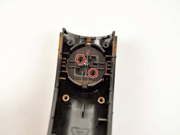

  12. Xbox 360 Wireless Speed Wheel D-pad Replacement: crwdns2935265:012crwdnd2935265:01crwdnd2935265:01crwdne2935265:0
    • Lift and remove the black, plastic backing of D-pad. The front of the D-pad will detach as you pull the back off.
