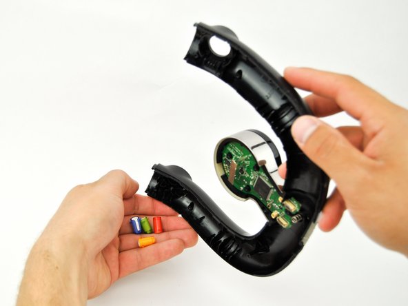

  11. Xbox 360 Wireless Speed Wheel A, B, X, Y Buttons Replacement, A, B, X, Y Buttons: crwdns2935265:011crwdnd2935265:01crwdnd2935265:02crwdne2935265:0 Xbox 360 Wireless Speed Wheel A, B, X, Y Buttons Replacement, A, B, X, Y Buttons: crwdns2935265:011crwdnd2935265:02crwdnd2935265:02crwdne2935265:0
    • Remove the silicon pad on the left side to expose the A, B, X, Y buttons.
    • The silicon pad held the buttons in place, so without it the buttons should come out effortlessly.
    • Flip over the controller to remove the buttons from their sockets.
